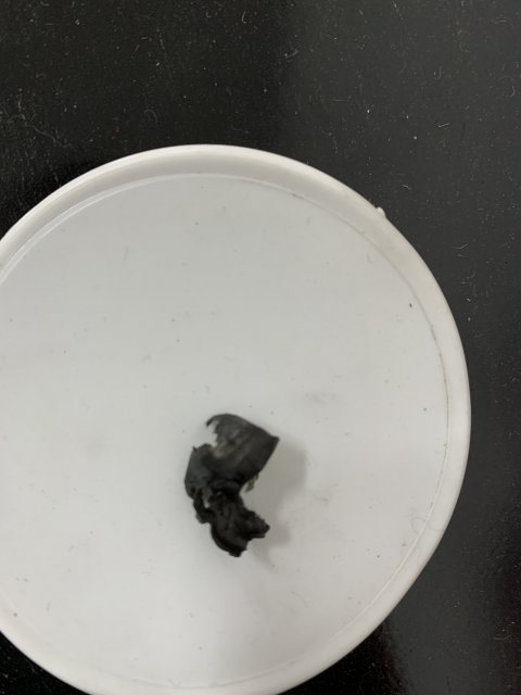

Undoing the dss drive shaft and When I’m taking the bolts out this goop is falling out. Is this a worry?

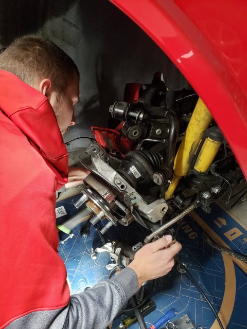

I went over and helped get the axle out and brought over a stock axle so he could get it running.
Jon assessing the situation
Yes, what normally happens is the diff breaks & then the axle goes when the diff internals lock up. That's why I suggested dropping the diff anyway to begin with.

Thanks for the help I should have pulled out the 12mm Allen originally….

Both axles are out. The remaining of the broken one will be out this week.
