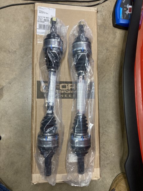

Well it’s been a long while since a post here, cars been down since about the end of May as I removed the axles to return them for inspection because the had a vibration in them at high speed especially if unloaded after a 1/4 or even worse a 1/2 mile coast out from 180(by unloaded meaning push the clutch in and coast or kick it into neutral and let it coast out bleeding speed) When I installed the Axles last year they had a very visible wobble to them. After running them and feeling the vibration I removed them and measured the stubs and found them to be around .002” smaller in diameter then stock and RE axles I had.
So GForce told me to send them in for inspection so I removed them before going on vacation for 2 weeks with the hope of having them back soon after I got back home. GForce found the stubs to be on the edge of the lower acceptable tolerance limit and replaced them under warranty, only problem was they weren’t in stock and I had to wait on them, was a long wait!! But was worth it as I was greeted with a set of brand new axles when I opened the box :)
I measured them for comparison to what was sent in and stock and found measurements showed them to be about .001” bigger then stock and about .003” bigger then the first set. They still slid right in without issue but this set no wobble :). A test run to 140 and back yesterday was vibration free so the axles where definitely the culprit.

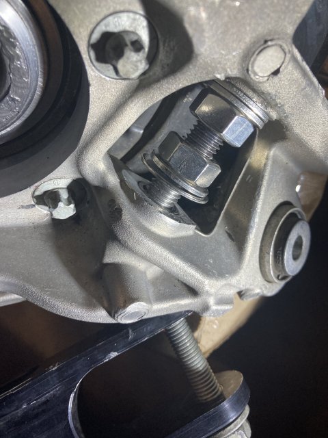

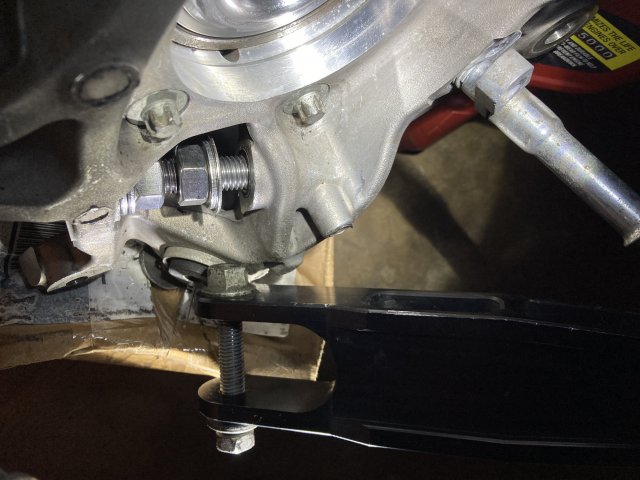

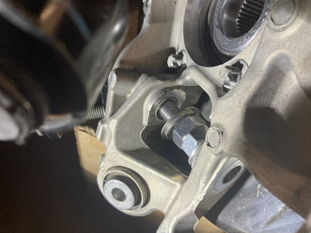

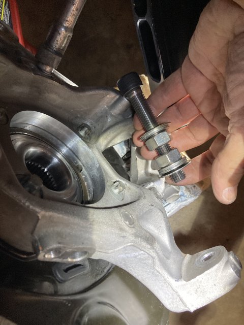

In installing the axles I tried a new technique that @jonx96 suggested to me to try, using a bolt and nuts to push the bushing in the lower knuckle in out of the way instead of the crude didn’t seem right hammer and drift method I was using. MUCH easier and effective!!! 2 wrench turns on a nut pushed the bushing flush up against the spindle body allowing the spindle to drop right one the lower control arm and effortlessly align the holes to slide the bolt in place. So I figured I’d share the technique will all who have been keeping interest in the continued adventures of GoManGo lol.
I used a M14x2.0x 85 mm long socket head cap screw and used a die to fully thread the partially threaded grade 12.9 socket head cap screw, then added 2 nuts and a few washers.
Slide the bolt in in the same way the original comes out, add washers, 2 nuts, 2 more washers and thread them up the bolt until the bolt can align itself into the other hole in the spindle. Then with 2 M22 open end wrenches (or 2 adjustable wrenches), hold 1 nut in place, turn the other about 1 full turn and the bushing is pressed flat into te spindle totally out of the way!!

Sure took the biggest PITA part of the job out of the way. If any one wants to buy a bolt and not setup let me know I can make some up being threading the bolt requires a M14x2.0 die which many probably don’t have. $25 shipped, add $15 for each additional setup beyond 1, flat shipping rate fir as many that will fit in a USPS Small Flat Rate Box. PM me if you need one.

Hardest part is fining the proper bolt to do this with. Most aren't threaded all the way at the local hardware.
To anyone who is going to say why didn't he drop the diff. Geforce Axles cannot be changed by dropping the diff!!!! They will break. Ask me how I know? I am getting faster and faster at doing axles. I have done them about 8 times in the last 8 months :ROFLMAO:

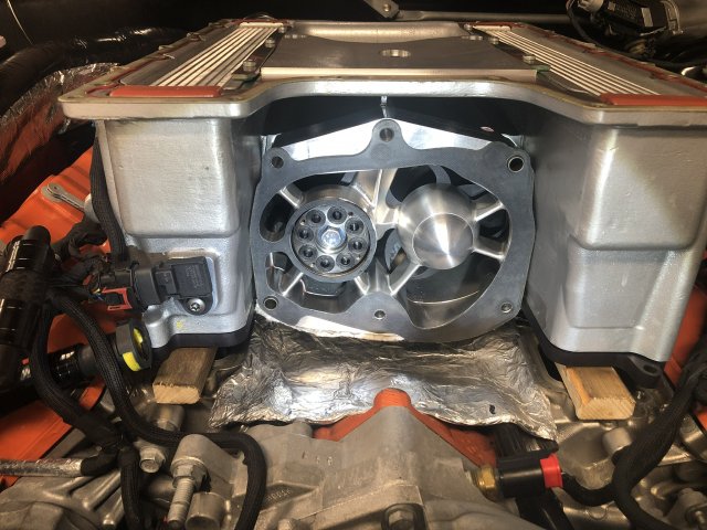

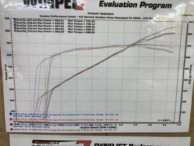

Here ya go. Yes, a solid 50 hp. This on 93 with a can of Octanium per 15 gallons of fuel. 2.85 upper stock lower. What was added was the FAS billet plate, port matched snout to plate inlet and opened up inlet to match a Fastman modded 95mm TB
Little to no change in IAT but I run a chiller. Only increase in IAT I’ve seen is since I’ve added a +10 lower and stepped down to a 2.72 from a 2.85. The better breathing can be seen from 5500 rpm and up.

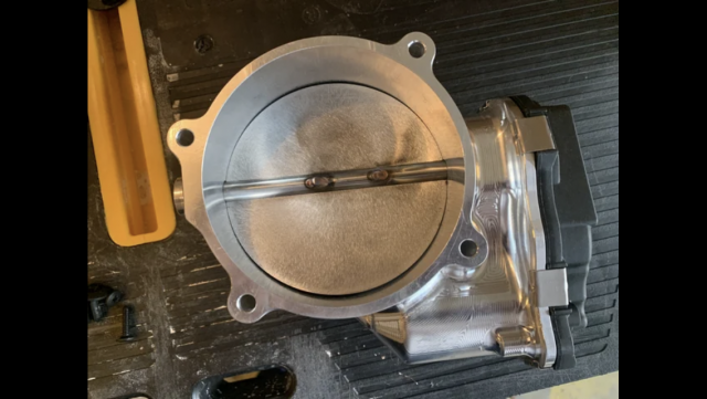

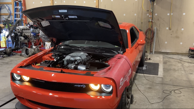

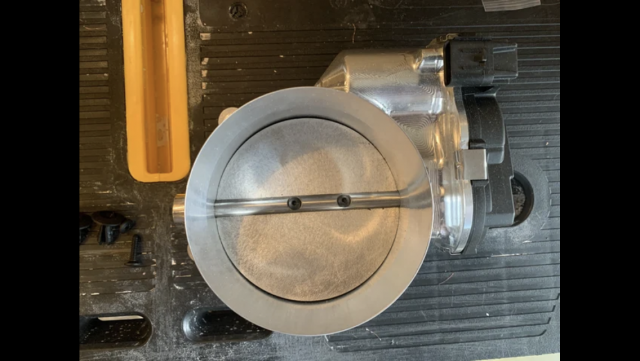

This weekend I’m hoping to dyno test a change from a BBK 100 TB to a HHP 105mm TB. Being that my aircharge is up allot now after adding the +10 lower and 2.72 upper might be restricted some by the 100mm valve. Hopefully we will see Saturday, HHP TB due to arrive tomorrow. I’m really anxious to measure the blade diameter and see if it’s a true 105 or not, the inlet and outlet taper seen in pictures makes me wonder. Stay tuned!!

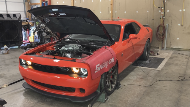

Ok, the results are in, BBK100mm verse HHP105mm throttle body. Same snout which is opened up matched to the 100 mm TB outlet, ie with the 105 mounted there was a 2.5mm lip restriction all the way around the 105’s outlet. So what was the result? Did it make more or less HP? If more how much? if less how much? or the same little to no difference?? Dyno pulls done within 10 minutes of each other, IAT and critical temps pretty much matched. All was done is a baseline pull, swap in the HHP 105, do a throttle relearn, and hit it again. DA was around 4300, ya, pretty yucky. Sooooo what’s the opinions?? This ain’t for free no more 😂

TO BE CALLED THE WINNER!!!🥱

My guess, is that you saw a negligible increase at the top of the RPM range.

Sorry, Was replacing pictures I put the wrong one and one was supposed to show the BBK mounted in the other the HHP mounted. Take a look again

Possibly a small decrease on the bottom end (velocity efficiency decrease) but I'll stick with my original statement.
