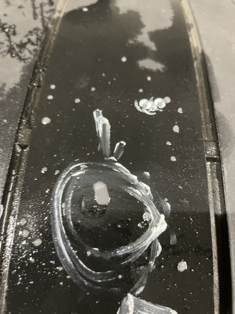

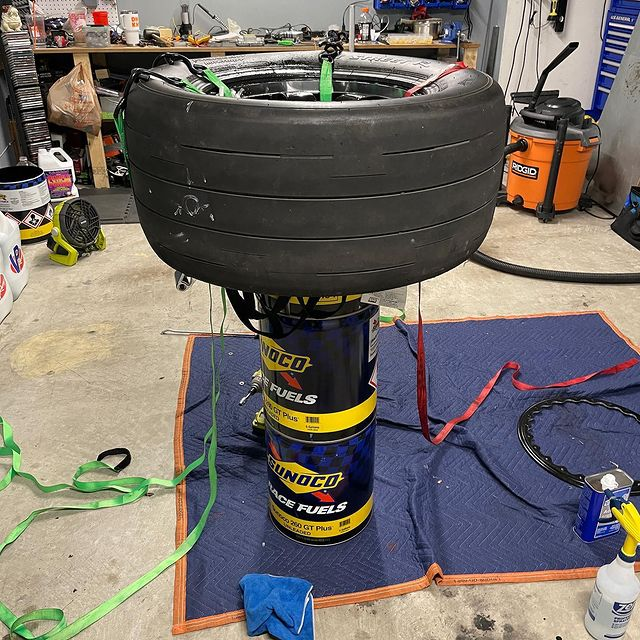

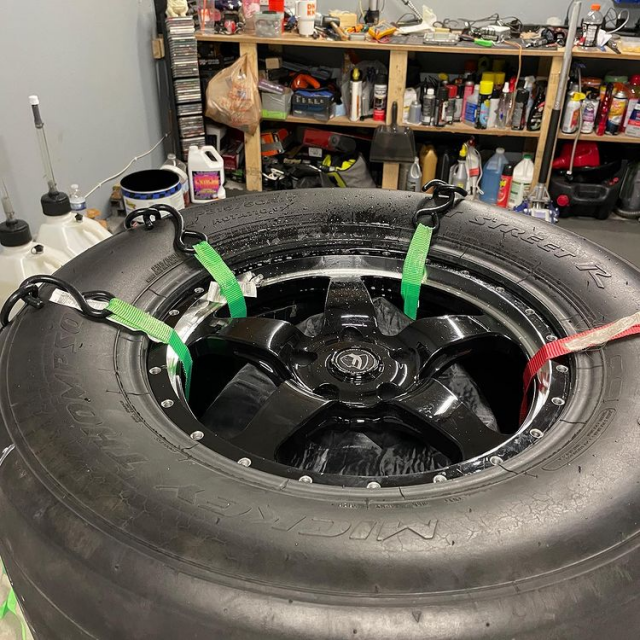

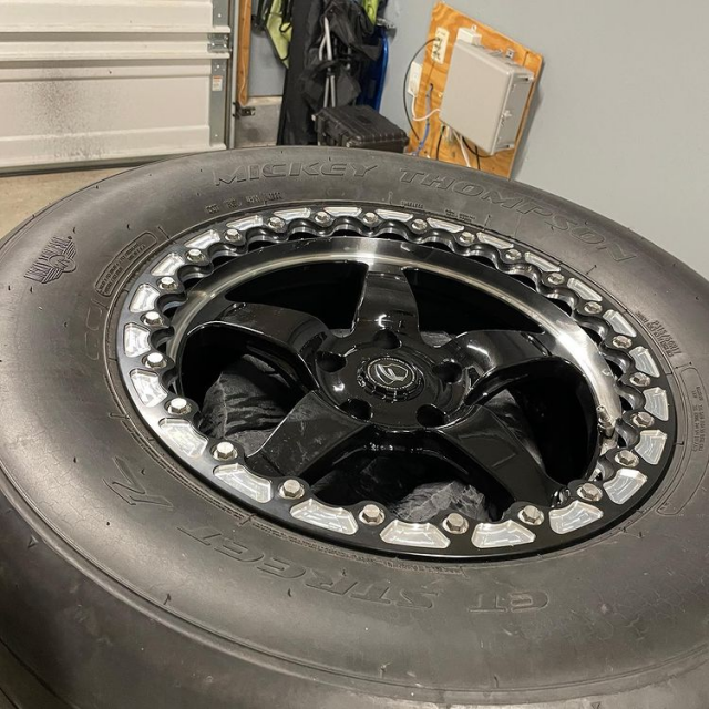

Well I'm in a pickle. Looks like the patch isn't going to hold. Introducting the Beadlock 5000, the backsaver 8000000
Sad though, getting micro bubbles.
Going to check it in an hour…

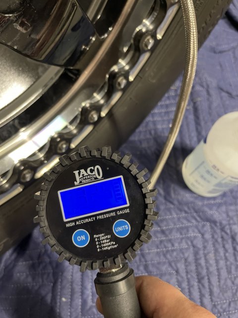

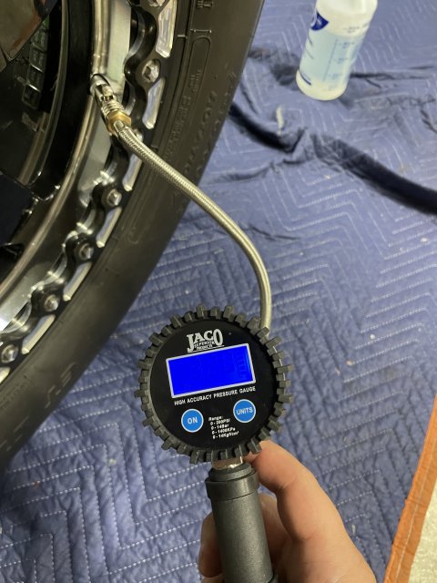

Sorry, quite angry. So the "pickle" is this. I want to be in Streetcar-Takeover this weekend at MIR (Aug 14TH). If the patch does not hold I cannot get another 315 in time. That would mean putting on the 305/45r17 I have which I don't want to as they are brand new. At 1830 the tire was at 32PSI, I will do another check at 1930 and report back. Sorry words, yes I should use them better.

What patch kit did you use?
So this was an adventure… the last time I had to patch a radial I used one of my uncles vulcanized patches with matches aka a sizzle patch… get to autozone… OSHA apparently doesnt allow that anymore. Bought Slime… and they are shit. The rubber cement wouldnt hold and went through two patches. Took it down the block to an old school mechanic and he got it right. He laughed when I told him about the last time I patched something. Told me all the new patch kit sucks but he uses the harbor freight ones. All same shit made in China. https://www.harborfreight.com/60-piece-radial-tire-patch-kit-97215.html

Still at 32psi, done issue. If she goes, she goes.
