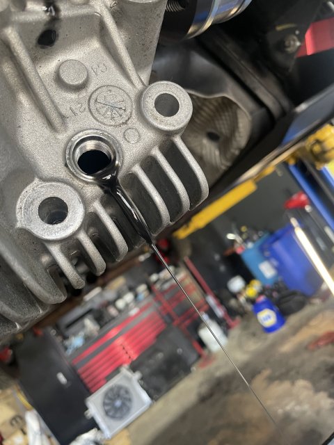

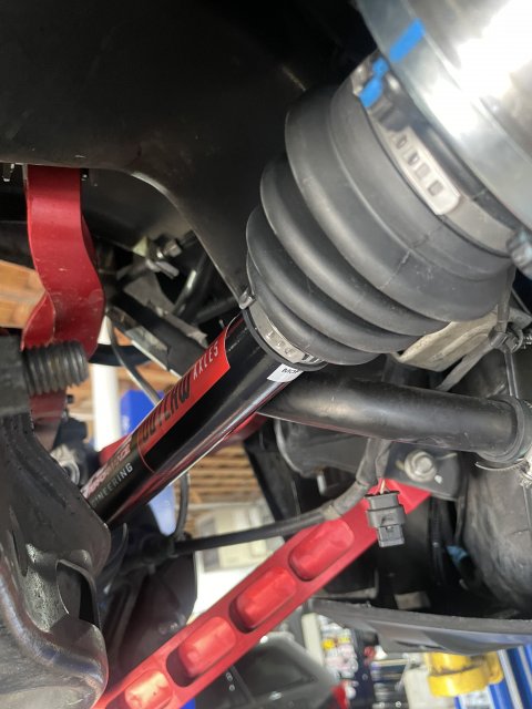

Was putting axles in, decided to service diff as well. Car feels way different in a good way. Drivers side axle was showing wear and tear.

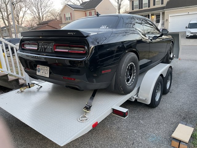

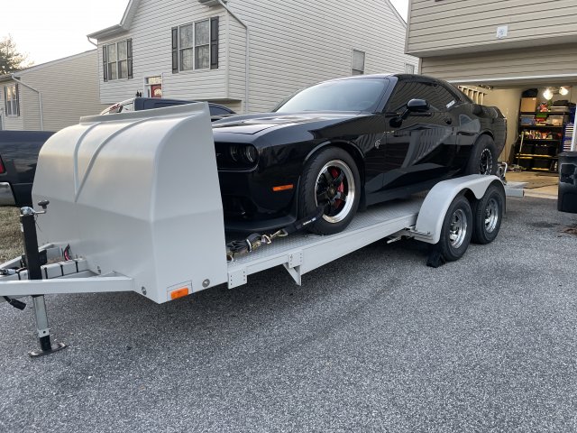

then to my delight learned the trailer would clear the driveway slope due to it being flat. I thinking I could get used to this bougie life!

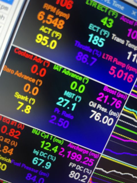

Not a problem broski. Start of pull: 62.6
End of pull: 87.8
Keep in mind air charge temps start to pull timing based on the following values in the tune:
You could move Part Throttle Ref IAT to 999 and it would never pull timing...
Didn’t you upgrade to triple pumps? Pump DC 89%, FP 79/80 psi, Or is that how it works on the control setup you’re using?
