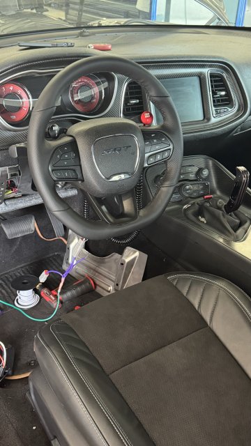

Thread Starter #155
8,421
7,343
Looking good! You’ll get it sorted, just do what I said. Few places can bench flash it for you - trick is for them to bench flash it with an OS that’s already been unlocked for HPT (bench read of already unlocked pcm)
