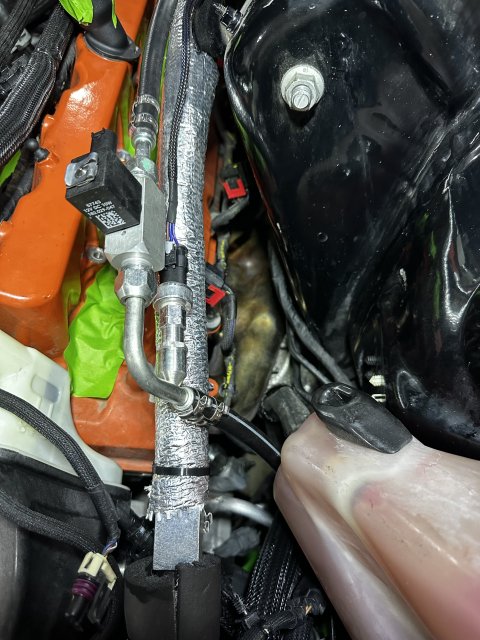

Thread Starter #84
Passenger side completely out. 2 bolts left on driver side. Going to be a pain due to my chiller refrigerant lines

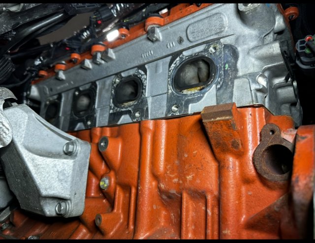

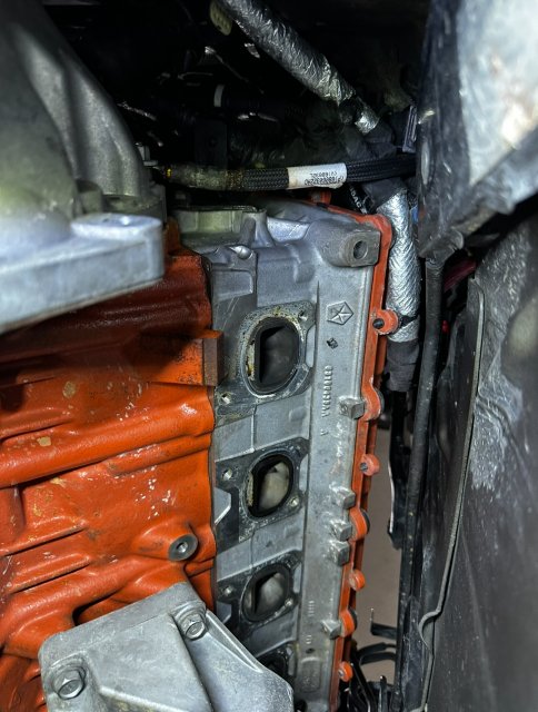

Thread Starter #89
Still a pita with chiller lines, but not much worst that stock. This gives you a lot more room (still a pitta)

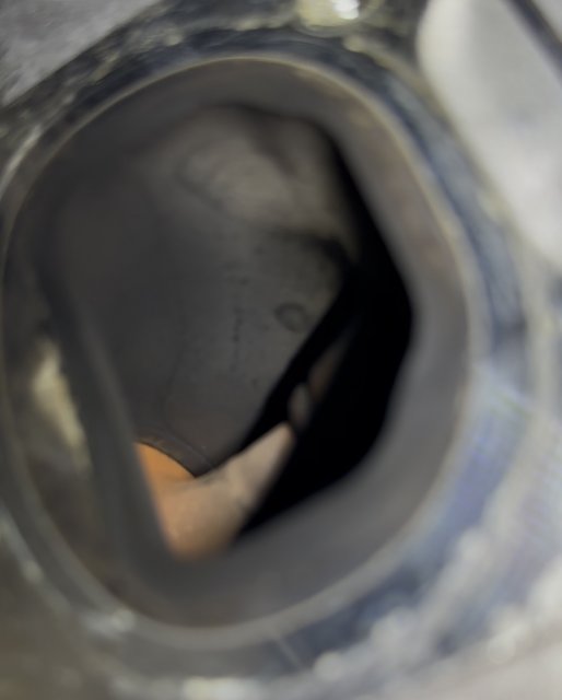

Thread Starter #90
Ports could be worse. Tops of the valves are orange.
7,716
6,522
Thread Starter #91
really nothing to clean off of the heads. Suggestions? Brake cleaner and a cloth?

#92
Red scotch brite or snapon cleaning wheel.

#94
I suppose since it's just the exhaust ports, maybe it's okay.
But here's a great demonstration why not to use scotch bright to clean aluminum mating surfaces.

#95
Saw some orange earlier in the thread too. From octane booster?

Thread Starter #96
Never used octane booster - 91/3 and e85

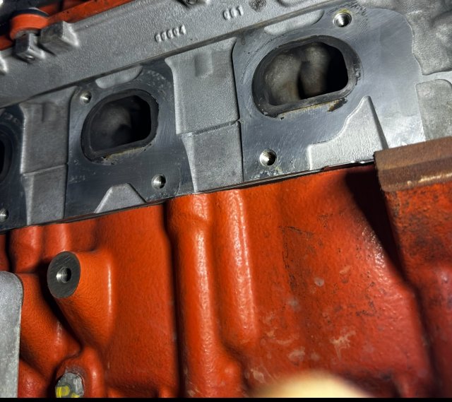

Thread Starter #97
Welp slow and extremely light and scorch brite left small scratches in the mating surface in the heads. A bit weary since it’s a metal to metal seal

#98
Might need a light coat of RTV to make sure it seals.
7,716
6,522
Thread Starter #99
I’m getting it off but I don’t want to keep going over it, especially since I can only go over pretty much 1 at a time. Don’t to create low spots. I have more off now than in this pic in those 2. I think rtf might lead to more problems, not sure 🤔
