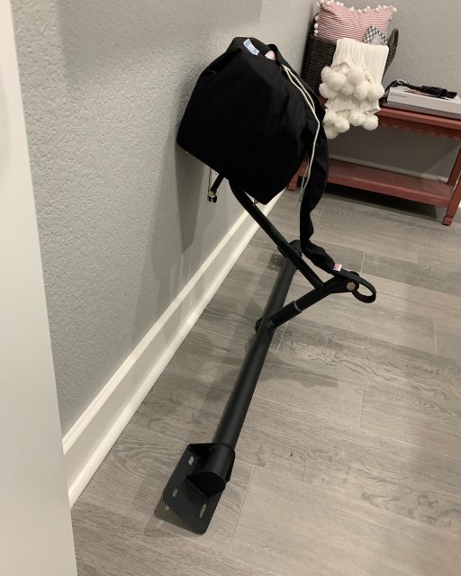

The anchor for my boat came in, I can not say enough about the service and craftsman ship of this kit from Carlin Fabrication.

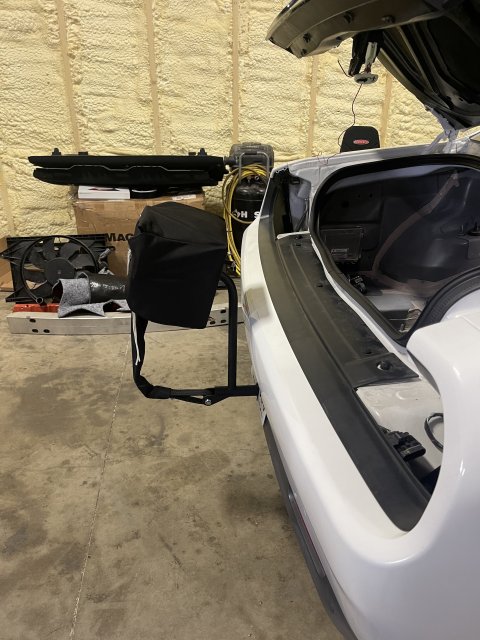

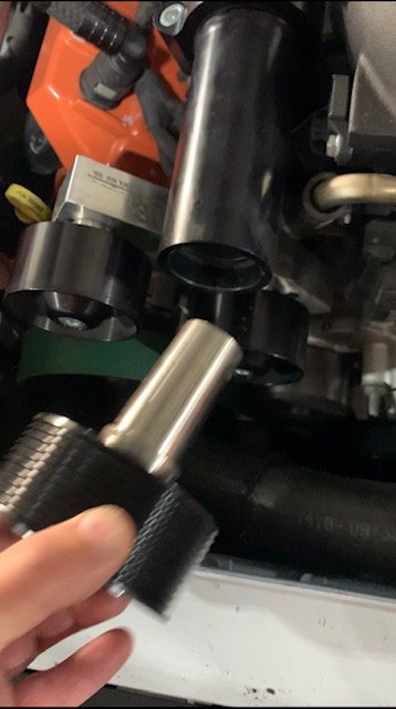

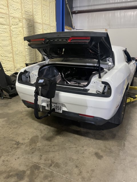

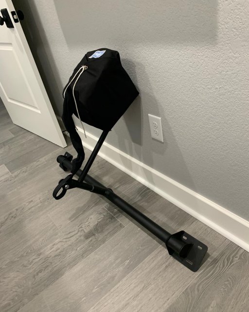

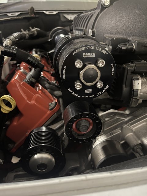

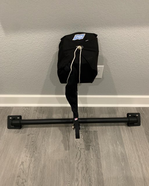

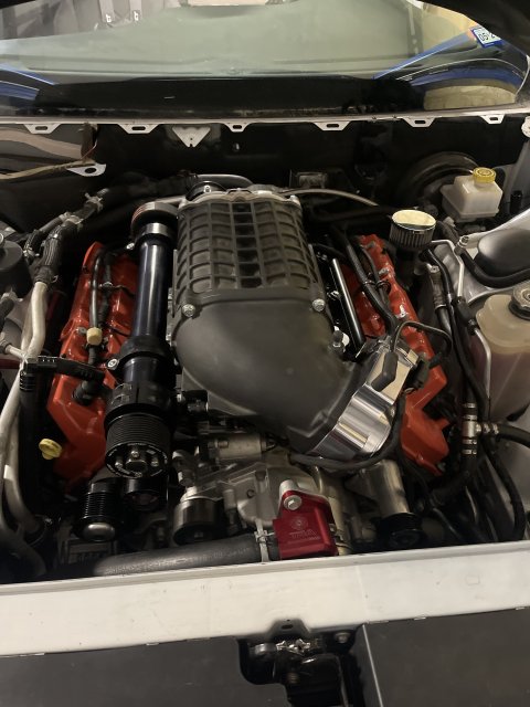

Some updates on the car: The new shaft for the maggie is installed along with a griptech 3.00 snout pulley, the parachute kit from Carlin is installed and have a few more fuel system changes to make and will be ready for it to be tuned. 7E4384F4-46CE-42CD-8E35-4677B0F44098.jpeg 9B0399ED-250A-4889-8DE5-2BF13C78A614.jpeg 3BD37041-3FF9-41AF-9847-08C0292C7A14.jpeg 5F55CC8C-8099-4D36-9FDC-17ACD91534F1.jpeg

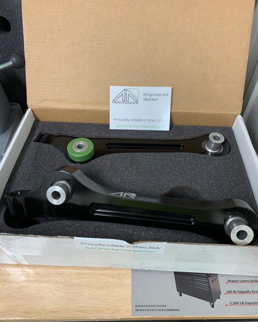

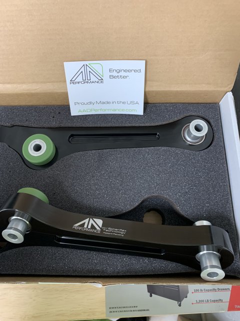

Received some new parts to shed a little more weight off Scarface. AAD front lower controls arms, these are 7lbs lighter than the stock ones. C5BA4BD0-F5B1-4129-8A80-5241181450F5.jpeg 2F567A50-1954-41D4-B1B7-E66B695FC189.jpeg

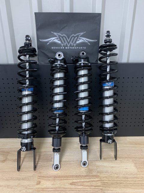

Thread Starter #86
I had a sponsor purchase me a set of Menscer Coilovers, these will go on next month with the rest of the front end parts. Hopefully we see a drop in the 60ft times when the track is crap.
my friend is currently running this set up. It takes a lot of time and energy to dial them in.
That is what I keep hearing, we have a couple guys running them that race out of the same shop as me and hopefully i can get some good baseline settings to start with.

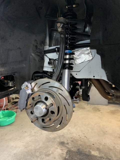

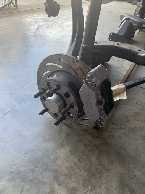

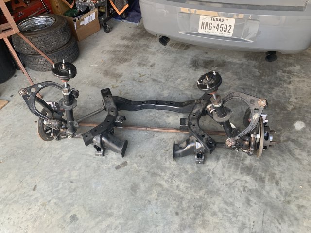

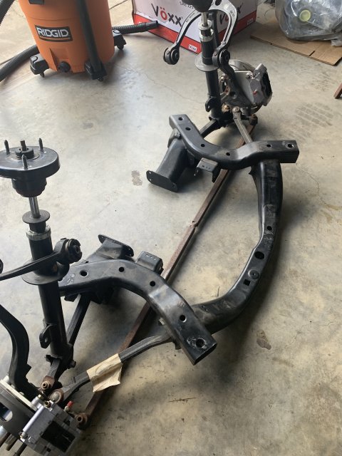

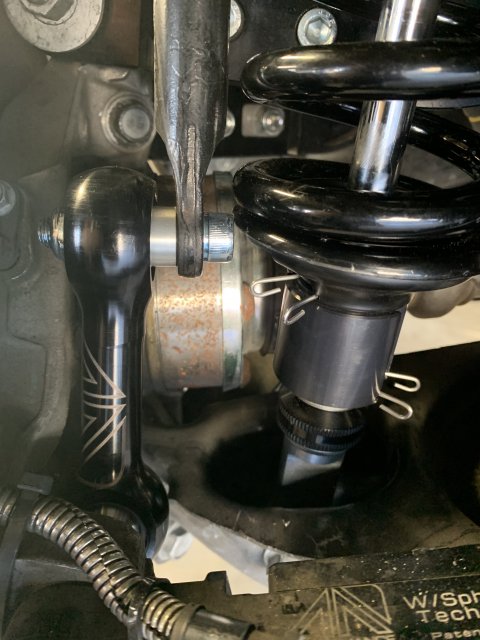

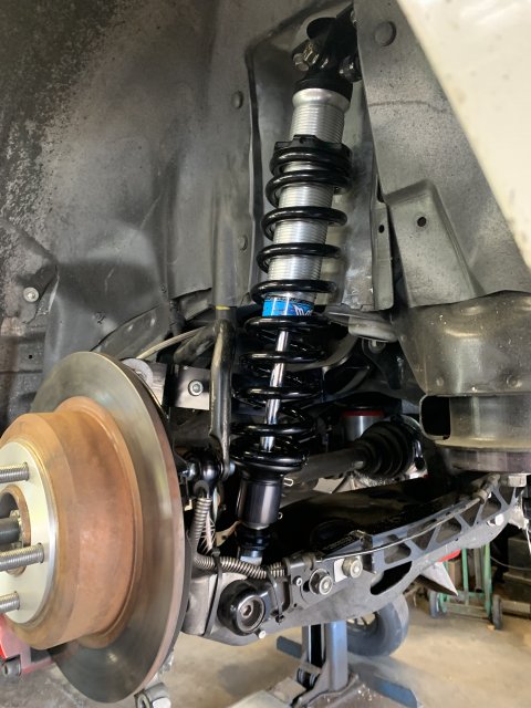

Finally had some down time at work and installed the Menscer coil-overs, early style front spindles, Strange front brakes, AAD lower control arm and AAD rear sway bar links. We measured ride height and then adjusted the coil-overs so the ride height was back at the same height so we had a baseline to start at. I will be replacing the front rotors with the Strange two piece ones, just waiting on them to be delivered. 24C5BA3D-5E06-4D33-A680-8327D584BB32.jpeg 834E7BD3-4266-4C2C-AAC2-8E3A56C074E3.jpeg AAE5AB83-7612-4B11-B370-31790E9ABDC2.jpeg

#90
Make sure they put the proper spring on mine came with 200 on front needed 300

Thread Starter #91
What does your car weigh and what are your weight percentages? Trying to see why you needed 300lb springs. All the high end coil-over kits that are on the market have 16” 200b springs for the front.

#92
Stock weight super stock talked to Mark Menscer told him what I had as I had zero lift on my front end he couldn’t believe I had 200 on my car and sent a set of 300

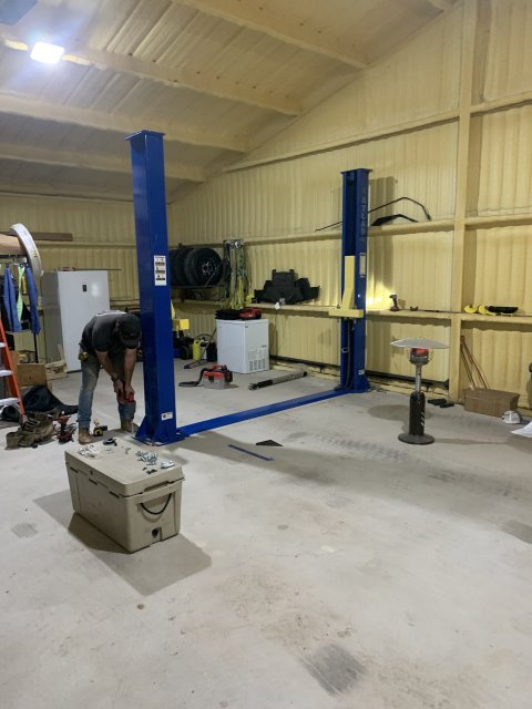

Not an update on the car but definitely an update to make working on the car easier. I have had this sitting in the garage since august and finally getting around to installing it. CC95A8A4-8DAF-4B36-99AB-FC9F1D1E424A.jpeg

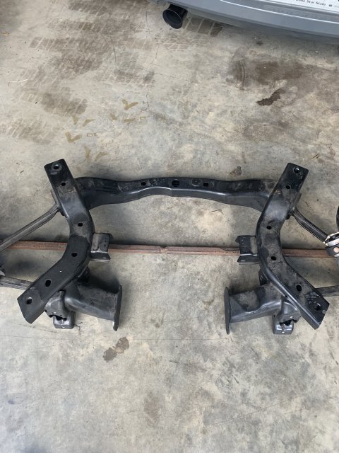

More progress, new cradle, manual steering and engine are installed. Still waiting on a few small parts to install the Magnuson and the new Sipple Built transmission. Got the cage set-in the car and will start the install today.
View attachment 64498 View attachment 64499 View attachment 64500 View attachment 64501 View attachment 64502 View attachment 64503
Im in the process or purchasing the flaming river rack. Im keeping the stock steering column this year. What U joint did you use? Are there ones compatible with the stock column?
