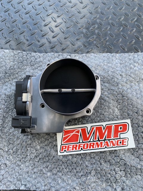

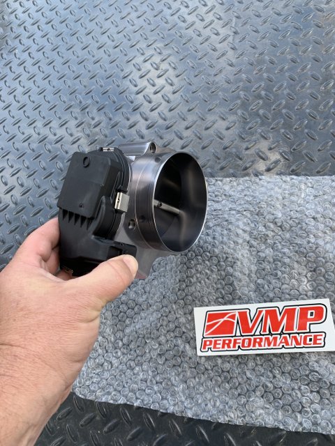

Have decided to go with the Magnuson 2650, ID1700 injectors, Tapped Performance triple pump setup, VMP 105mm throttle body. Will run on stock motor until this spring when I have a new one built.
The VMP throttle body showed up today. AAA9CDD4-B3E3-4CC7-8A00-064A136EBA97.jpeg 5E35F9CC-BB54-4AC8-912A-2C6D895EC52F.jpeg A75FCC43-B458-4574-98F0-5628A87E15EB.jpeg

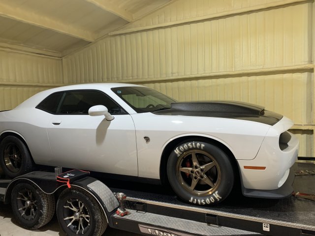

Thread Starter #32
My new rear wheels were finally delivered today, took RC Components right at 4 weeks to build and ship them. These are 15x10 with a single beadlock, going to run the 315/60/15 MT ET Street Radial Pro. C6E0F083-BB27-4B4F-BB56-8713E505F4B2.jpeg F59D803C-7DFB-46A7-BAA3-16C6500D8175.jpeg 4D3E8318-62A8-4393-B3B9-E1046EF21007.jpeg

Thread Starter #34
Nice choice! Those are beautiful wheels.
Thanks Marc, I ordered the 15x3.5 fronts to match just waiting on them to be built and shipped.

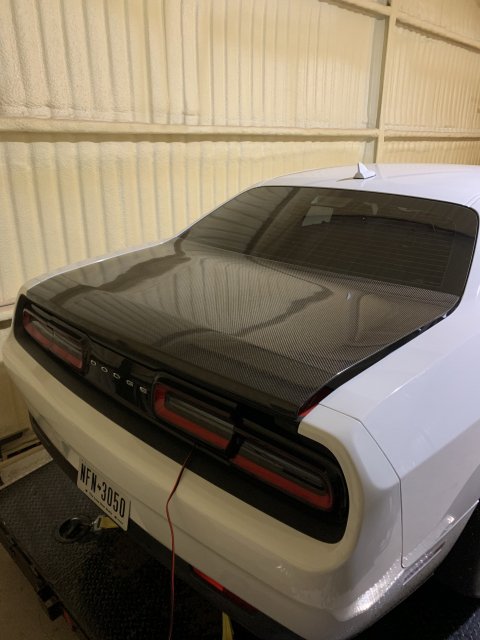

Thread Starter #35
Installed the carbon fiber trunk lid. The carbon fiber one weighed 17lbs vs the 41lbs for the stock one with spoiler and camera. 1D279F02-7A7D-444B-B082-C242CC7BCEC5.jpeg F7D89AF1-680E-45CD-92F8-2AC684C9428C.jpeg

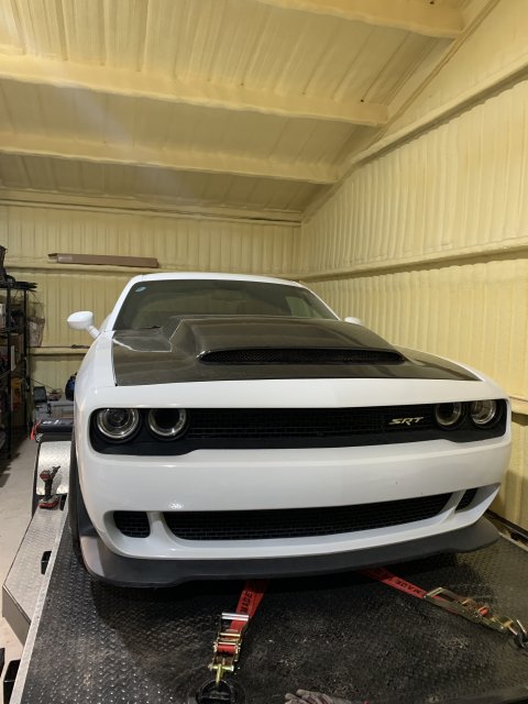

Thread Starter #40
Finally got around to installing the new hood this morning. It think it looks pretty damn sexy! 367A2864-E2DE-44E3-BC3B-50F53AA5AB4A.jpeg 2AB04C95-6A47-4CFC-B3D0-3900A88B6CF4.jpeg EB2B1703-B81C-44CE-8D7B-FA08C715CBDB.jpeg
