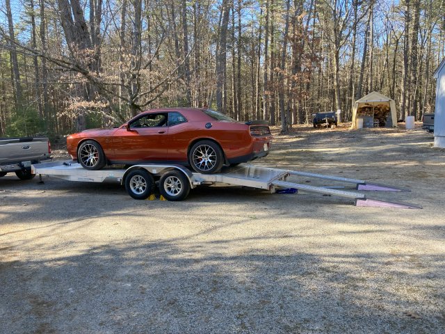

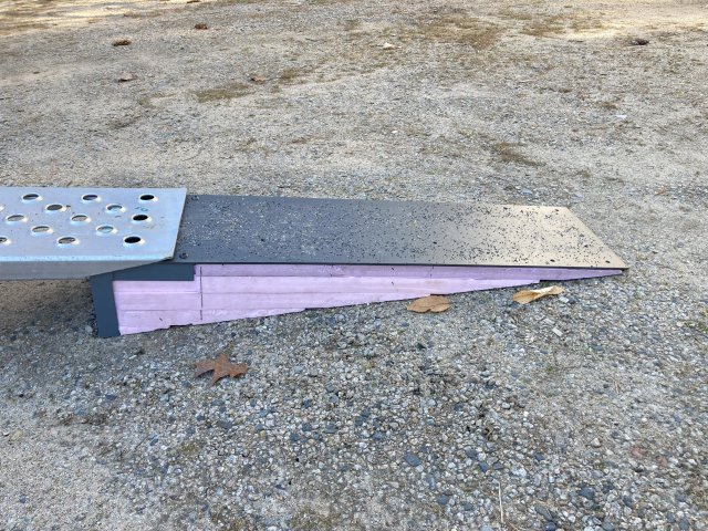

Spring FINALLY has arrived and I was able to set up the trailer. First was testing the custom race ramps I made, they work perfectly!

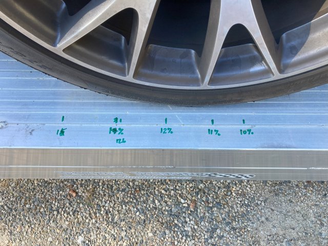

Next was figuring tongue weight, I set up a beam with pieces of steel angle to act as knife edges to put 1:3 on a bathroom scale. Then calculated tongue weight % based on car location and marked it. Now I have a reference so if anything funny happens at speed, I can adjust and know where from and where to.

Nice!
Go a bit heavy on the tongue if you want...it's a whole lot better than not enough.

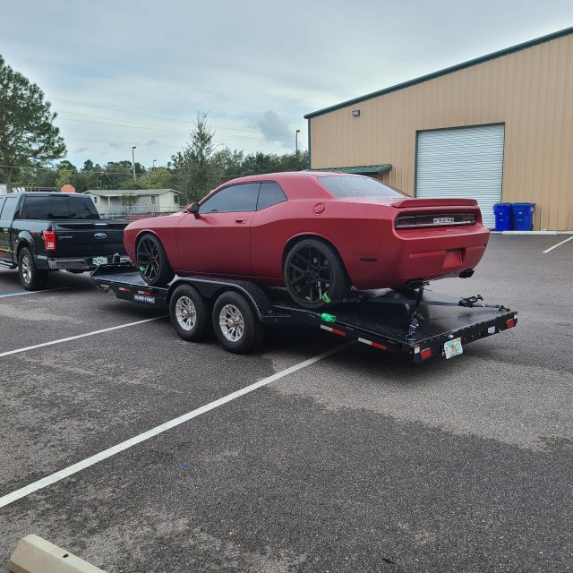

F150, 24ft. Look at position of car.

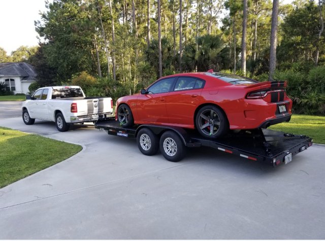

Same trailer. Different car and truck. Look where the rear wheels are.

That's also a heavier trailer, putting more weight on the tongue even when empty.
