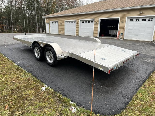

Found a Cat trailer that looks pretty good, is there anything I’m missing?
1,984
4,976
20HCM6 22RENBS2
Found a 2021 Rance 20’ 7k alum trailer, weighs 1335# so gross weight would be about 5835#. Light weight is important because I’m towing with a 1/2t.
It will be summer towing only so road salt will not be an issue.
Asking price is $6500. I can get a cheap steel 7k trailer for $4k new, but 700# more weight. I like steel better, but the light weight should be much easier on the 1/2t truck and much more driveable.
I have never trailered a Cat, only boats, horses, dirt and stone, so thoughts and advice would be appreciated.
(BTW: He has a nice garage!)

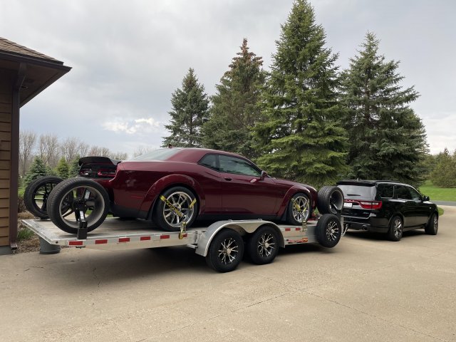

I expect to put anything heavy like wheels and fuel in the bed fwd against the cab. I don't see any other weight on the trailer, unless I add a winch.

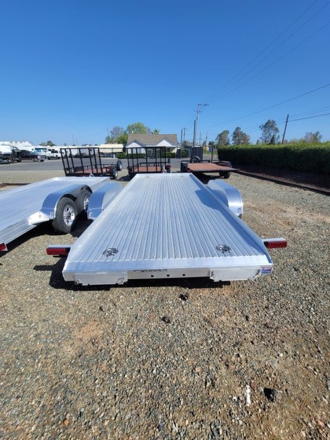

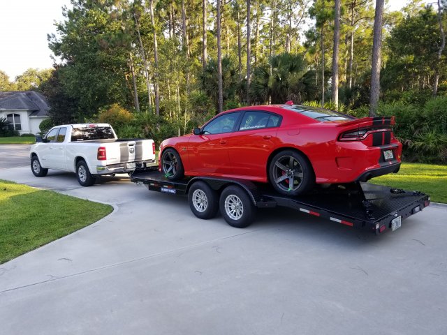

That sounds about right price wise at least if it was here in Calif. I like the fact that has a beaver tail, but then again my Orange car was pretty low and made it on my flat one pretty easy. I paid $8,800 OTD for this 17.5' 10k Featherlite a few years back new and could still probably get close to that here. Rare to find 5200# axles under one but wanted light and short behind our 40' Beaver. FXwycPvn.jpeg

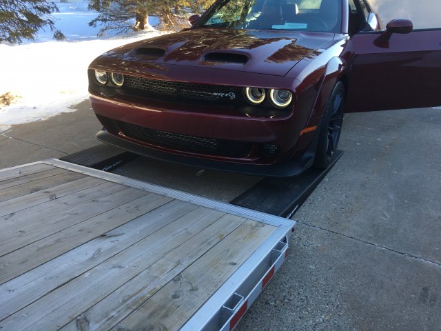

One other thing to double check is width, between fenders or rails. I believe a wide body Hellcat is 79" and my Featherlite posted above and here is 78-7/8" inside of the raised rails. I didn't buy it for that as that is obviously too tight and if I need to haul it I will have to use my 24' Enclosed Pace as it is 82" between wheel wells which is tight as well.
