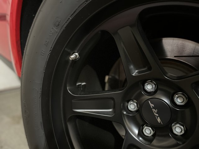

I installed factory Tpms inverted (Not a good idea)
The tpms sensor nut came loose after crossing...
You really can't blame the sensor for what appears to be an improperly installed valve stem. And it sure doesn't help if also installing the sensor wrong on the valve stem.
Valve stems for TPMS can be used as regular valve stems. Just unscrew the sensor, or don't install it on the valve stem in the first place.
