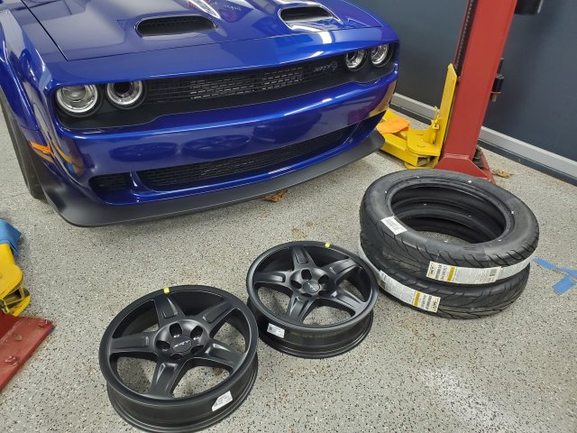

Anyone know if TPMS sensors can be installed on Demon skinnies? And which ones? Looking at Schrader brand and they have about 6 different ones for a 2021 Super Stock. Clamp in vs snap in, and some look to be positioned differently. 20211208_171914.jpg

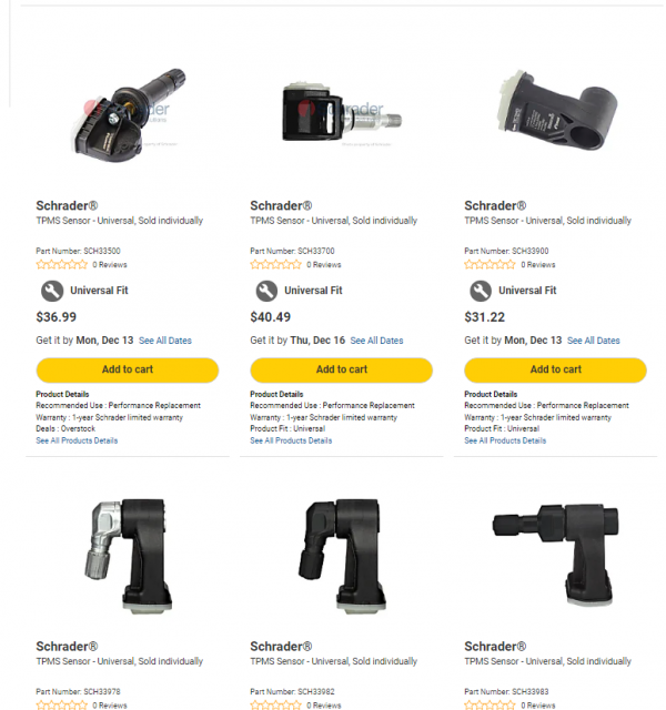

And here's an example of the different styles that come up when I put in my car's info on the Schrader site: Screenshot 2021-12-09 182929.png

If you buy normal OE sensors for a '21 Challenger, they should work just fine.
They don't know or care what kind of tires they're in.

I don't run the Demon skinny but I do have the very similar Forgestar D5 in 18x5. I used the same TPMS as vortecd suggested.
