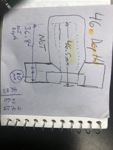

How much (longer than stock) bolt length?
Searching, can’t find my notes except this one, but I don’t know if this is new deeper nuts on longer stud or stock. Sit tight, still looking, memory says 56 mm under the head, let me confirm
This shows the rim thickness but not thickness of the brake rotor and bearing flange

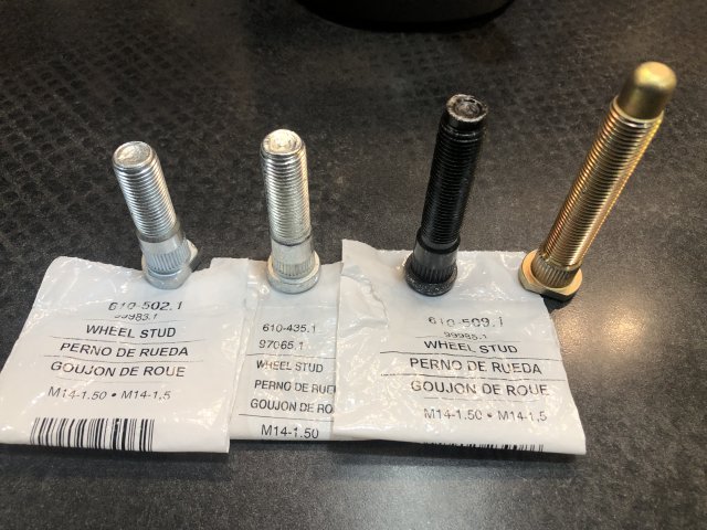

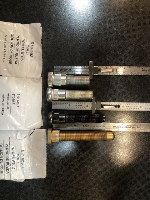

Still didn’t find where I wrote down a dimension, spent hours so far looking in the shop and in past posts and pictures, wtf did I do with the note????
Any ways, I found these pictures, 65 mm under the head more like it as I cut the bottom gold colored ARP stud down to fit and remember in my lathe cutting the round top off and about 5 threads off. I’ll measure a stock stud and add 12 mm to it and see what that number is. DA88C55F-8BB2-4D51-8886-BDE088B5DE7E.jpeg 122AAC02-DC56-436A-B2D0-F24EEADD5E8B.jpeg 68E61F17-EFC7-4099-814E-656A700488D8.jpeg 20D9EC0A-61AC-4908-98D2-CD715C96D9E3.jpeg
