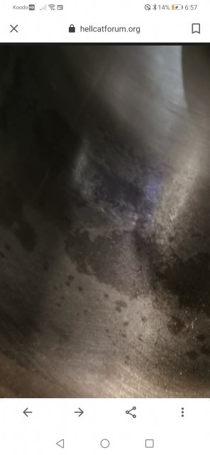

@BULL what do you think this pic is of? Screenshot_20210703_185744_com.google.android.googlequicksearchbox.jpg

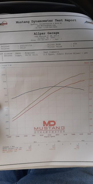

Picked mine up. FINALLY.
Allpar and curt nailed it.
910 on their mustang is apparently spicy according to what they usually see from this mod set.
That DJ estimate. Lol

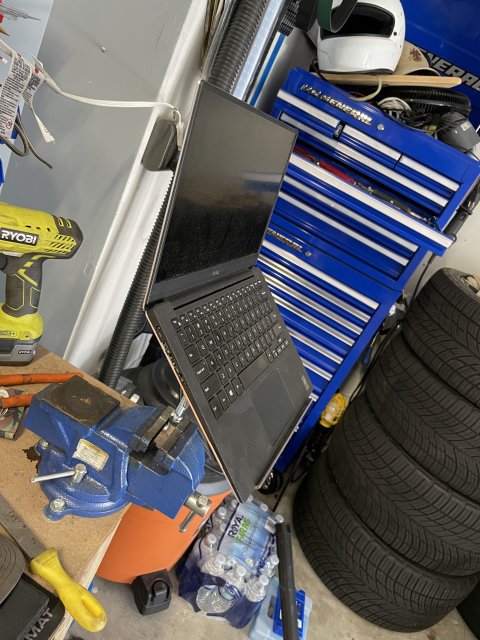

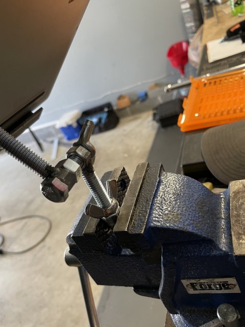

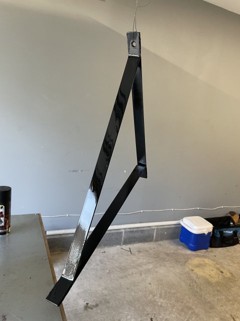

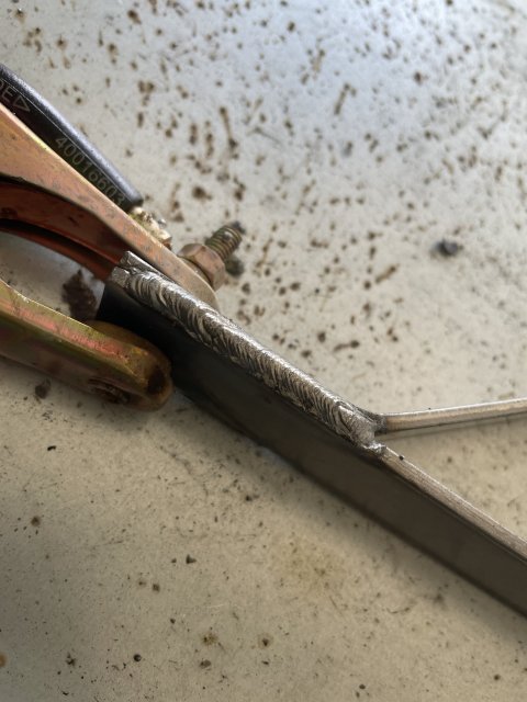

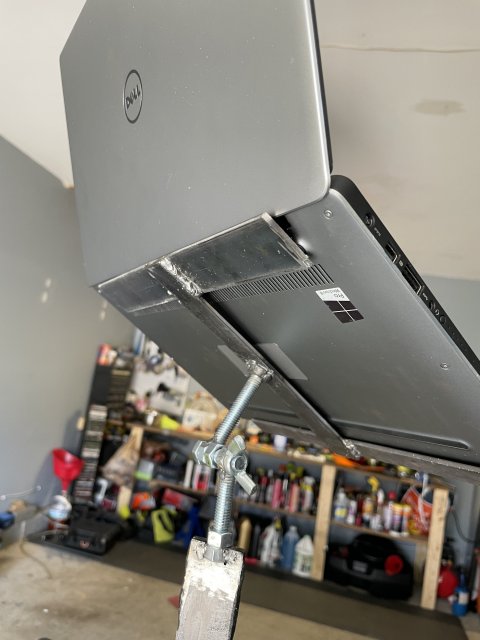

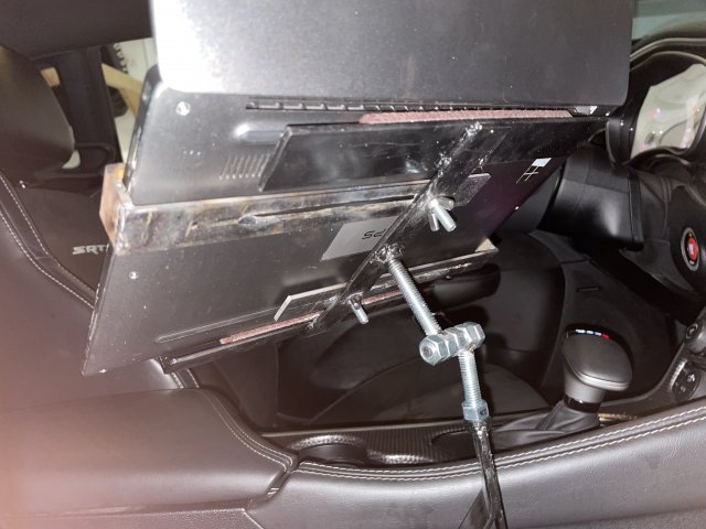

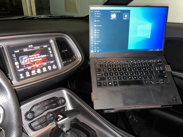

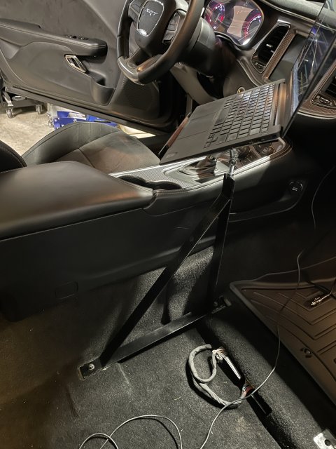

So at the track I had my laptop go flying… well I ended that today…
FD510E69-319D-4A5F-86B9-E9A68EDA0E80.jpeg 82F3D255-E76E-4AC6-8258-7325573F5199.jpeg E41FAC68-968F-4C74-A91A-6A2E4910E914.jpeg 71D3B5EA-E0B6-4680-8AB6-F44D169F33F6.jpeg 6CE8907A-1E8F-425E-A592-48EB8B41D06B.jpeg 9177B9E4-57D6-4454-8F8C-2213932CF277.jpeg C1BFE7D5-AB5B-4BE0-9BDA-072F81D02356.jpeg E13C7C1D-138E-4445-9514-06D63B6977EA.jpeg
I’m not a fabricator, a grinder and paint make me the welder I aint. It can rotate on all three axis and is pretty damn stout. In the top pic you’ll notice that the arms have no paint. I finally painted them and they are drying. All done with flux core welding. So yeah not pretty but the welds are stout.

Show how it's mounted to car?
3,866
9,531
Using factory hardware and the holes for the seat. I don’t have an interior anymore…

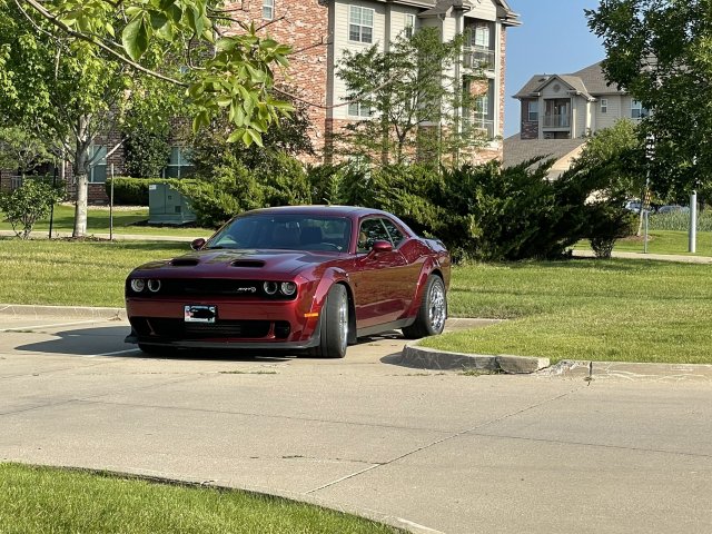

Gave it a wonderful place to rest last night. It spent a rare night in the wild away from home.

Front drivers wheels looks like steam roller wide from the shadow. Looking good as always.

Good eye. Almost as big as those rears. I had to switch to 325/30’s (bit shorter) the wheel width and position make even a 305 rub the front liner. So had to use Cup 2’s. I never use it in the rain, if I did I would change the wheels. But these big expensive meats run so nice, soft and quiet down the road. It is a great highway car. All the race alignment settings don’t bother anything a bit either, it handles and streers great. No strange tire wear either.

Thanks for all the R&D on what works and does not, in particular with suspension, handling, and tire combos it hasn’t gone unnoticed. It will most certainly come in handy for myself and others. Yes the Michelin’s are great I switch between them and 555R2 in the back. Run nothing but PS4S up front, probably get a set of customs made to toss on MT315 Street R also.

You..you..left it....outside.....unattended.....:eek::cry:. @BULL . Banishment!!! That's worse than unsolicited political commentary! :LOL::ROFLMAO:.
Seriously. I'm bringing mine for a tune Thursday and they want me to leave the car. I'm scared sh^t about it. Never did that on any of my cars, anytime. Last time they did it (my '09 SRT) I stayed all day and waited.

It was in a nice ‘hood, near a trailer rig to block other parkers and with cameras around and let’s say we would know where it was if it became misplaced. Plus found 93 octane for sale for less than $3 around the corner! Now in MN already.

Nice work but they make stands like that. I have one I was using in my mustang. It attached to the seat bolt on the floor and it is fully adjustable like yours
4,338
10,746
With you having a Charger it'd be easy to find one out of a cop car. Hmm now you have me thinking. I think I know some places to check to see if I could get one to fit my Challenger. I may know some places to check for one. I'll see if I can find you one to. :)
