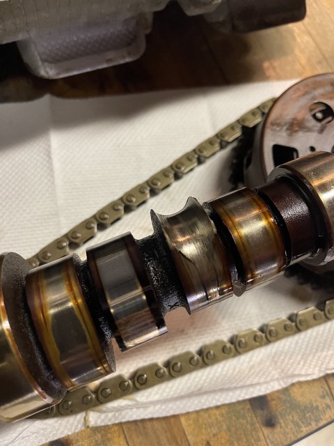

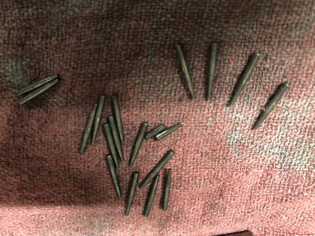

I caught a bad lifter at 144,000 miles in my 2013 Daytona 5.7 before it wiped the cam. It was a non MDS lifter in #5 cylinder. The needle roller bearing went out and I had an engine code that read miss detected in Cyl #5. The car was a daily driver for mostly highway miles. Changed the oil every 5,000 miles or less religiously at the Dodge dealer using BG MOA oil additive. BG offers a warranty up to $4,000 parts and labor if you follow their guidelines. You have to remove the head to replace the lifter. The Dodge service manager forwarded my service history to BG and BG covered my $2,300 lifter replacement 100% in less than 24 hours! I did not have excessive idling. My oil pressure at idle was typically 30 psi and 53 psi at normal speed. I believe it’s just the lifters are a weak point. Some last more than others but the needle roller bearings don’t last forever regardless of the oil pressure. In the future, I will replace the lifters every 100-125k miles in my 5.7 if I want to keep the vehicle...but I probably won’t keep my 2021 JGC 5.7 TrailHawk that long. It will be available in the next 2 years @vortecd if you want to get another well maintained 5.7 Jeep? They aren’t available anymore… IMG_6105.jpeg

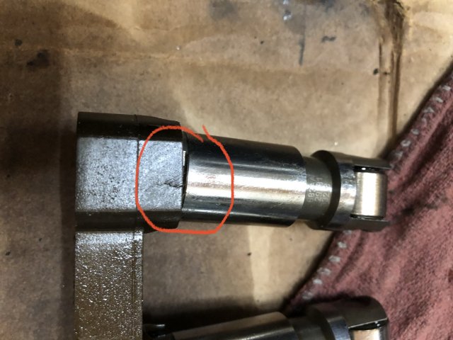

I replaced the cam, lifters, VVT, timing chain, oil pump, and eliminated the MDS system on my daughter's 2014 392 Charger (around 90,000 miles?). I used the Hellcat high volume oil pump. This was all done after losing the lifter on cylinder #2, and wiping the cam lobe.
I think I have watched all of the videos the guy on reignited put out on this issue as well as many other claiming to have found the root cause. The guy from reignited makes the best case so far and it sounds like he has seen more than a few hemi motors with this issue.
In his other videos he mentioned he has seen this issue much more commonly after the introduction of the VVT (around 2009 ?).
Personally I think the VVT system when operating with the MDS system, low oil volume, and possibly dirty oil may all combine to create oil starvation issues. Another couple contributing factors could be the lifter guides not adequately controlling lifter rotation and the needle bearings in the lifter roller.
Here are some pics of what I found on my daughter's 392:
IMG_4367.jpeg IMG_4465.jpeg IMG_4464.jpeg IMG_4489.jpeg IMG_4488.jpeg IMG_4359.jpeg
I am not claiming to know the causes but I think the reignited guy's theories make the most sense. My daughters issue was with a non-MDS cylinder and I can only speak for what I witnessed.
If you go with the MDS delete (cam and lifters) consider using the aluminum MDS plugs with a light film of RTV on the top o-rings and clean the MDS cylinder carefully on the top o-ring surface - oil leaks are not uncommon in this area (ask me how I know - been there done that)

I have read that the Hellcats had a new lifter design with larger needle bearings, but I have not seen it firsthand or compared the design changes. Supposedly that design change was carried forward - but I do not know that for a fact.

Good point with the metallurgy comment, looking at my failure and seeing "wear" failures for a bearing surface, or multiple bearing surfaces (needle bearings and trunnion) in my case is concerning from a part spec requirement standpoint, meaning it points to a design failure or heat treat failure where lubrication is actually present in sufficient quantity.
