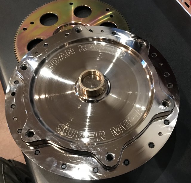

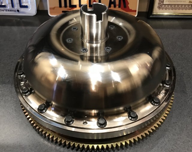

Converter porn 🤤 C2C0305C-4D4C-404F-A19E-559B45F66DB3.jpeg 5756B50D-D315-45CB-B11F-4E8725DD5899.jpeg

Hey Marc - not sure if you know of or follow Steve Morris, but he has a new prototype bolt-together, non-lockup from Chance - all billet titanium! For the Boostmaster. Weighs like 12 or 13 lbs. I can't imagine what that thing would cost
3,429
10,996
I know who he is. Mine weighs 25 lbs. I can’t even guess what a 13 lb chunk of titanium costs. My guess is … more. 😝
1,335
3,410
yea, he weighed them in a recent video - his current billet stainless converter was like 21, and he said that one was a $7500 unit!! :oops:
