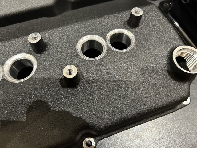

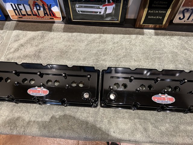

Lol. That’s ok. Btw…. A set of their new cast covers will be going on this engine. I already run my coils upside down so that’s good. I ordered them with the black wrinkle finish without logo. I can’t run another engine builders name on my Spankintime built motor. Geoff confirmed that they will clear my T&D rockers. I already have a new set of Cornerstone billet covers but I’m not sure yet if they will clear. I’ll be selling the 426 that I’ve been running as a complete long block and will probably include those as part of the package. They are beautiful. IMG_7166.jpeg

Interesting, setup for VVT, but I don’t see any bolt provisions for MDS plugs? Surprised to see it have provisions for the MDS solenoids (if that’s what I’m looking at)
Those are not mds solenoids. They look like the following.
if he’s running a dominator still, vvt is not supported. I use a lockout on a 6.2 phaser, that blackbird gear is nice!

Wonder what the holes are for, maybe casting? Interesting. Just noticed they’re threaded, so easy to plug up

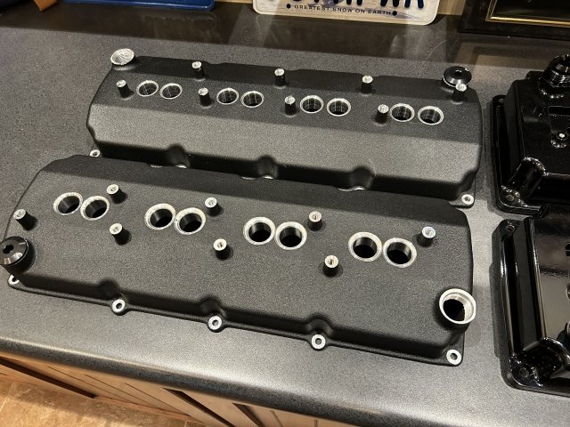

I got my new Blackbird valve covers. First… right on time! Geoff said first week in March and here they are 👍🏼. Not knocking any of the billet covers out there. The Cornerstones I have are nice. A big plus that I wasn’t expecting with these new cast covers is weight. They weigh 6 lbs less than the billets. What a bonus that is for somebody looking to shed lbs. I opted for the black wrinkle finish. It’s perfect. At $399 they get my endorsement. IMG_7613.jpeg IMG_7614.jpeg IMG_7615.jpeg IMG_7617.jpeg

I got my new Blackbird valve covers. First… right on time! Geoff said first week in March and here they are 👍🏼. Not knocking any of the billet covers out there. The Cornerstones I have are nice. A big plus that I wasn’t expecting with these new cast covers is weight. They weigh 6 lbs less than the billets. What a bonus that is for somebody looking to shed lbs. I opted for the black wrinkle finish. It’s perfect. At $399 they get my endorsement. View attachment 159809 View attachment 159810 View attachment 159811 View attachment 159812

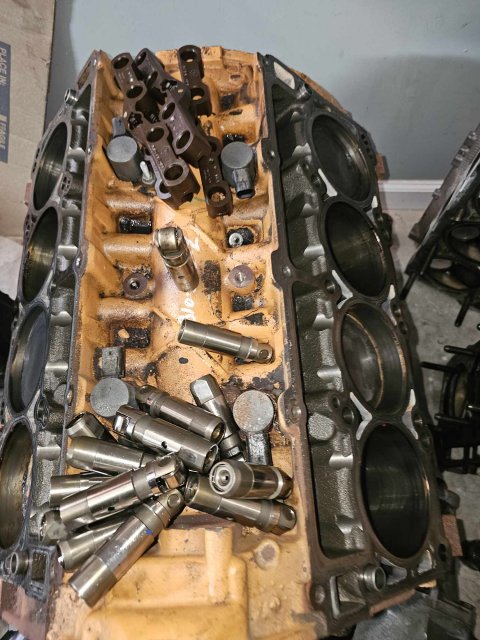

Also just a word on weight savings…. Once you’ve removed all the unnecessary parts and pieces that can simply be unbolted, it starts to get expensive to replace parts with light weight pieces. This block is 125 lbs lighter than the Dart. At this stage….. that is huge. One of the things you see on some of the faster Hellcats are CF doors. That is a $3500 weight reduction that gets you 60 lbs for your money. This block was $3000 more than the Dart. While certainly not as strong as a billet example (or the Dart) it is seriously upgraded to being a capable race motor. R&D insider at Callies says 2500 on turbos and methanol is no issue and that will work for me at our target weight of 3500 lbs.
