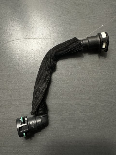

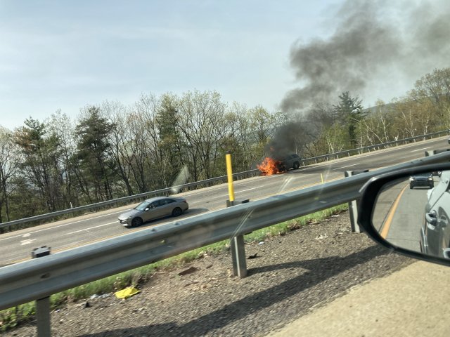

the earlier chargers/challengers hellcats have caught fire. The connect they used to the fuel rail if wasn't seated right would eventually blow off. They did change the design by 2018 or 2019. Z had a trans line fighting blow off and cause a fire. But his transmission was in and out a bunch of times so still hard to compare. I guess the question would be are you 100 percent stock? Have you had any major service done to the vehicle?

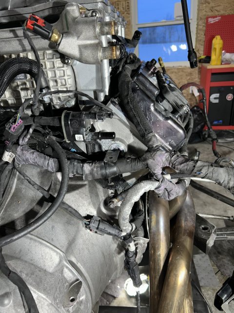

I’m still trying to figure out if the braided line is part of the hard rail or separate that can be back ported to earlier cars. Do you know @jonx96? Since you’ve had the engine out a few times

I safety wire my main fuel line to the rail and the cross over to the rail as well. I’ve heard of a few blowing off so I took an extra step to make sure mine can’t.
Anyone remember FamilyCruizin'? The speculation was he torched his
In my recent valve cover swap on the '16, I had to disconnect the main inlet line at the rail for the first time it had ever been off since car was made...I'd be lying if I said I didn't recall the Family Cruising fiasco and thinking about that thing coming off. Can't tell you how many times I kept pushing and pulling it to make sure it was good after reinstalling it. It has a latch lock so the fitting button cannot be pushed when it is in place - really can't see how it could blow off in normal circumstances, unless something is damaged or the joint/fitting design has inadequate margin against the blow-off load on it?
Mike - any pic's of how you wired yours?
