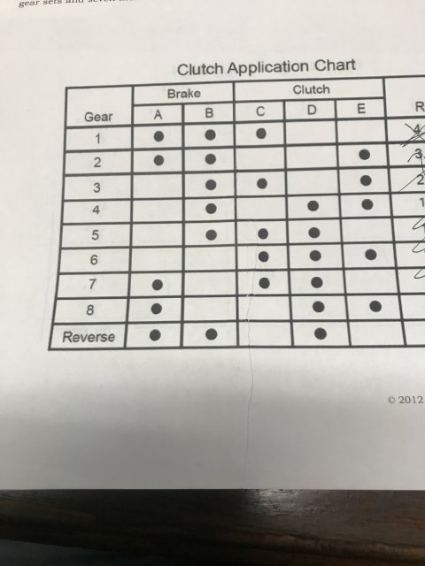

Thread Starter #44
Here’s a clutch application chart that details what is applied in each gear it’s from a ZF8HP45 but it’s the same as the 70 and 90 series B9EF2F57-7F4A-4E4C-8C74-8A3A439A3E6D.jpeg

6,836
17,592
Dang dude, fast work and great info. Auto tans make me nervous and I leave that to the pros like you. I kinda understand the clutch diagram, but can you explain it? So E and D clutches were slipping and those appear to be used in just about every gear.
