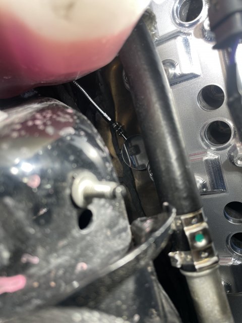

Feel defeated, these covers are just as shitty to put on as the other ones were to take off. In the video above the guy uses some 1/4" drive voodoo that I don't have. Will be bright and early at home depot to get robbed of some money for 1/4" drive extension and i don't have 1/4" hex sockets However there is already plenty of room already!
sometimes you gotta get creative… View attachment 97723 View attachment 97724

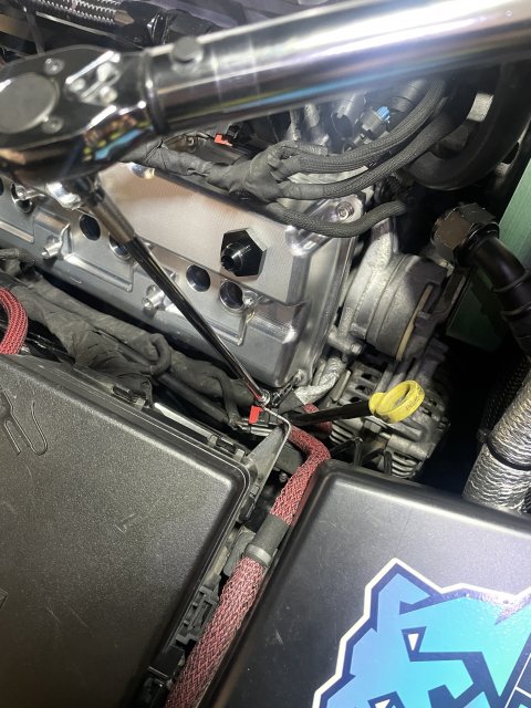

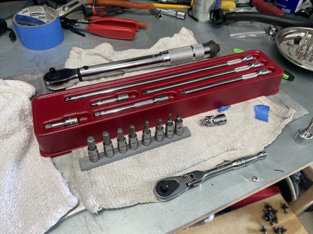

Added some 1/4” drive tools to the family.
Sooooooo much room, took 10 minutes

Where'd you find them? 👀
Home depot for the 1/4" hex drivers. Husky brand. For the extensions, Harbor Freight, ICON brand. 1/4" Drive torque wrench is Pittsburg. The flex head ratchet is OEM tools.

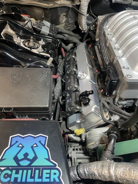

I thought the whole reason to get those covers was so you could flip the coils over and put the plug on the top like a 5.7? The plugs are what gave me issues trying to unplug a couple were a pain
Not at all, these are to remove that goof as fuck baffle so you can remove coils and plugs easily. I've never had an issue with unplugging, use ya fingys and squeeze. I can remove the coil packs and plugs in less than five minutes now. I am pleased with it so much. Dreading the driver side, I have to disassemble the power steering system as the reservoir covers part of the valve cover... fml.

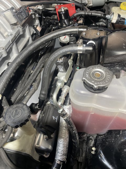

Just got done with drivers side. Making my new AN lines for the catch can. Easy day. This is what I was referencing @vortecd for space. Also use a mirror and inspect your gasket before and after torque sequence. Final result at 97in. Lb.
3,874
9,546
Thread Starter #1,173
Semi buttoned up. New an lines on driver side. Spent 48 hours thrashing, wouldn't have it any other way. Time for bed, gonna do the coolant side during the week.
