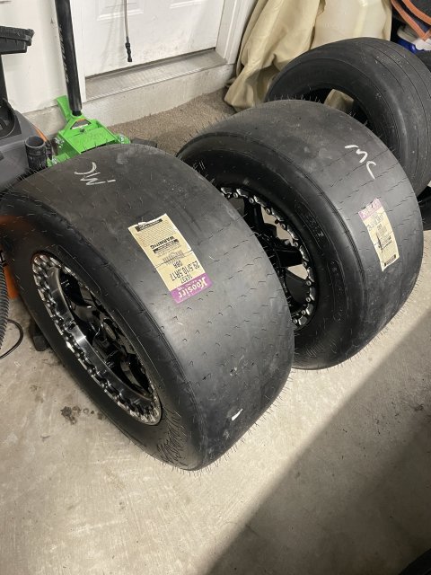

Big bishes on, she #thicc, happy to report longer studs and spacer doing their thing.

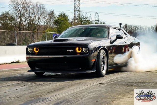

On the last run the car was getting hot, lots of issues in the staging lanes but it was like a freight train rolling down the track. None of the weather matches from last year so this is a hell of an improvement. Comparing the data from last season it is as follows:
9.703@140.75, DA: -842, Humidity: 51.00%, Temperature: 48*F.
The car is loving these injectors, I'm loving feeling competent enough to go in there and tweak. My review of the DBR's is still pending. Learned they behave more like a slick than a radial even though they have a radial compound. Also don't go below 18PSI otherwise they really behave like a slick. Was getting a little "jut" in the ass on the 1/8th cause they were spinning so fast they were folding over. Puckering moment for sure.
Plan to chop up and fabbricobble a video for sure. Since it was opening day the media guys there were all over my car cause with these big ass tires, skinnies up front, some top choice photos are incoming and will put a video out soon.

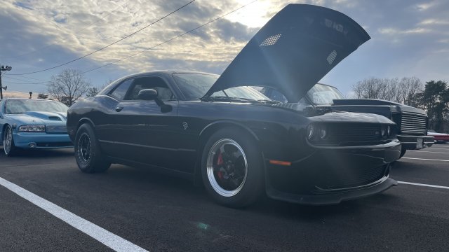

The taller tire for sure is doing that. One thing I may tweak is raising shift points. That MPH is going to get nuttier. Also she was a fat pig.

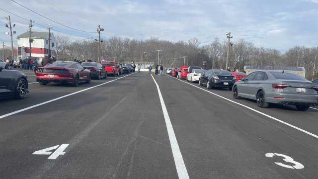

They decided on Monday to prep for the good weather. It was really a big turnout too, spoke with the owners and they said they wanted to do a soft launch to work out the new system.

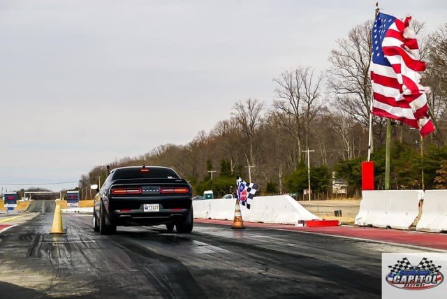

Track photographer went in!
