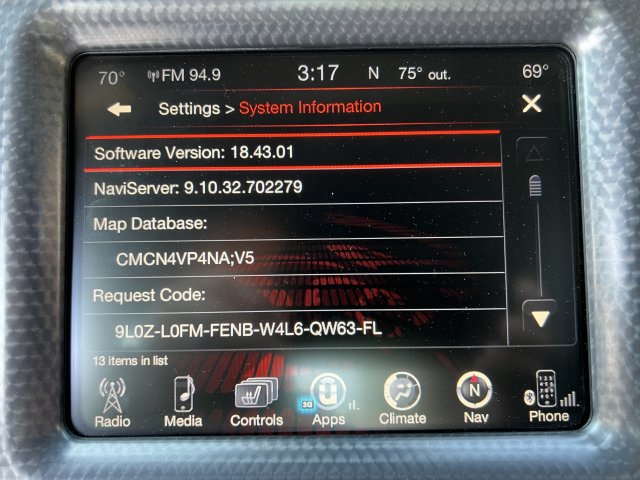

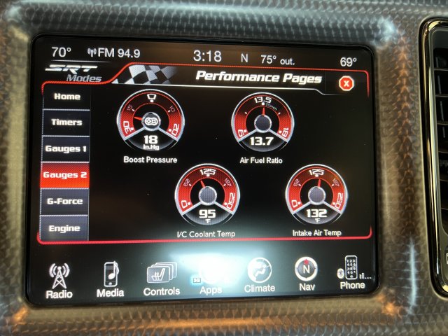

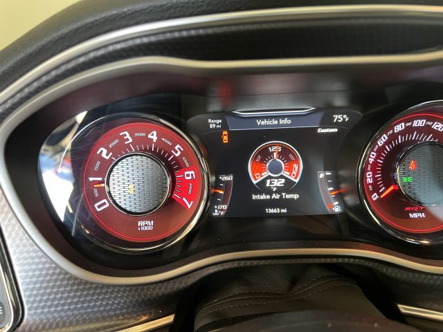

16,046
85,063
Assuming there is some "function" to load software from a USB or SD card and you can simply select the file to be loaded, theoretically you could load any version you want.
FWIW, this is the software version that I loaded with a USB drive some time ago. The IAT matches. ('16 M6)
15,913
49,835
4,469
17,976
6,863
17,674
Thread Starter #56
That all looks correct to me?
4,802
25,185
#57
My 2015 auto has 18.45.01.
AeroF16
#2826
2,197
7,016
#58
6,863
17,674
Thread Starter #59
You know what I meant lol
16,046
85,063
#60
I believe that's the most current one when I checked the Uconnect update site, today. Are your IATs in agreement?
