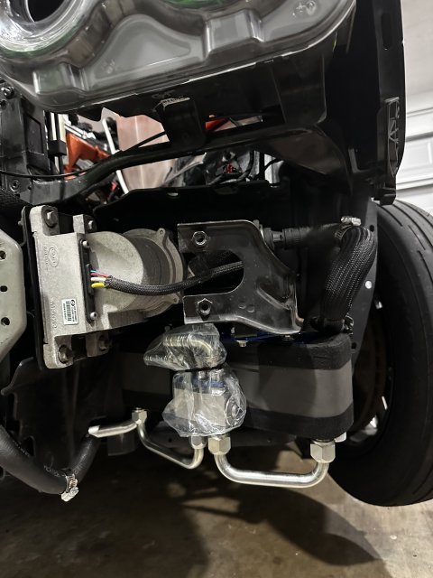

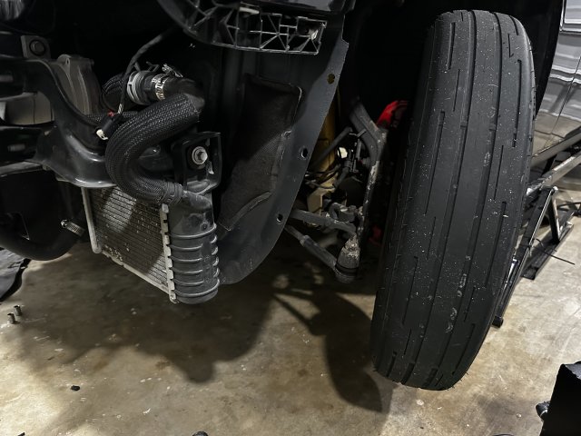

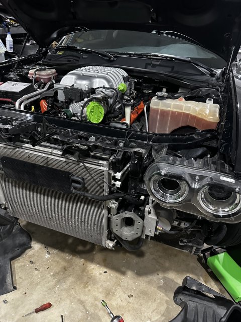

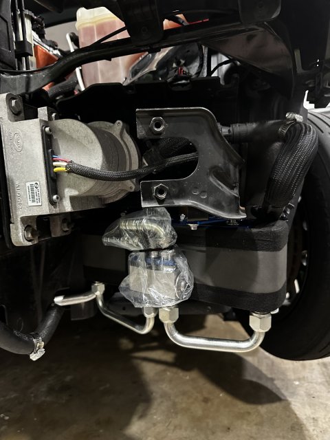

I made a video detailing my installation, as I said I would. I am not a YouTuber, and I never do that. But, perhaps, it will help someone out. I think it is worth a watch. I have a lot of time into the installation. Enjoy.
#22798
6
5
Katy
2018 Trackhawk
Very nice! Watched it start to finish. Love the attention to detail. I was going to use oem style constant tension band clamps but will look into getting those oetiker clamps, looks cleaner.
Also love the way you have it plumbed (chiller OR stock exchanger) to take the load off the chiller in stock exchanger mode (I'm in Texas).
Just a question, but besides the cleaner look, any other reason for not using the foam insulation on the hoses?
Once your up and running, I'd love to hear if the braid on the hose reduces/prevents condensation from dripping.
#23928
9
5
2022 Charger RE WB
I did not see a real need for the foam and did not want to deal with it later when it deteriorates and starts crumbling off. What a mess.
Having said that, I have not noticed any condensation on the thick fuel rated rubber hose I used from Improved Racing. Likewise, the braided line is dry. I get condensation on the metal fittings and the stock hardline pipes.
