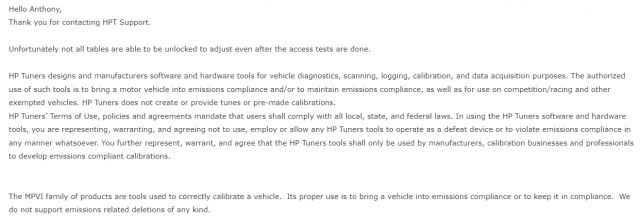

In any of your tune files, stock or otherwise, is "[ECM] 39210 - Weighted Catalyst Misfire Load: Weighted Catalyst Misfire Load vs RPM vs Load." editable?
6,800
17,483
My main VCM Editor version I use is 4.8.7 since that was before some of the weird change HPT made. When I open a 2019 RE stock file in this version the fields are editable.
However, I have a beta version for newer files as well. In this new beta the data is completely different and is a table instead of text boxes and it is not editable.
3,895
9,614
I sent a support request to HP Tuners and letting them known that the table is read only. Hopefully they can fix that.
3,895
9,614
You have got to be fucking kidding me:
But yet I can turn off DTCs... is this a fucking joke?
