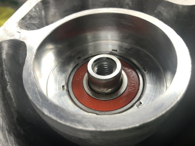

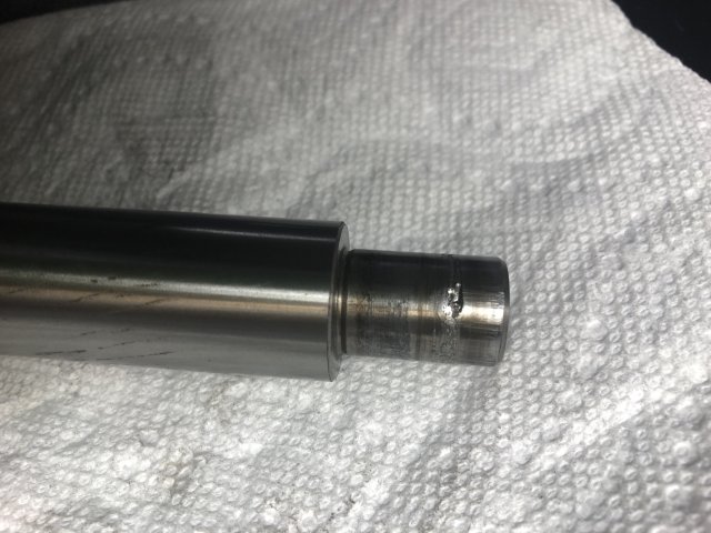

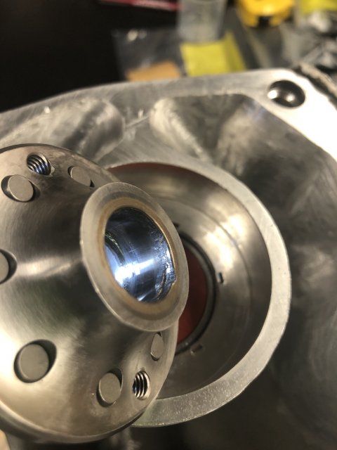

This is what happens if that bolt comes loose, hub spins on shaft and keeps knocking the bolt loose. If not too bad you can use loctite 680 on it, has to be real clean and grease free though. 55F7158D-879D-474F-B158-1621B4F943FB.jpeg D56A649B-4318-47BC-89B4-9C90AA6FE0CA.jpeg D187B4A1-E84B-4F8F-AFFE-04D0E11CA825.jpeg

Thanks Mike. But if that's the case,( and it may be it) why would it be happening? Did it spin and gall when It was locked up with the Metco tool but just didn't break loose when I was using the electric gun? And then she broke free when I used the more power full air gun, but the damage was done already?
I actually thought of the Loctite bearing retainer also. Would that work? Or would that be a half ass fix? Does anyone fix these correctly? Can I buy just the snout assembly OEM from Mopar?

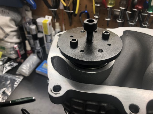

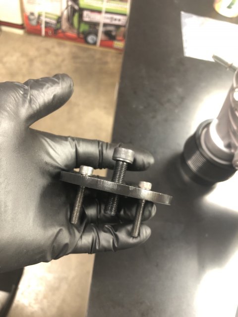

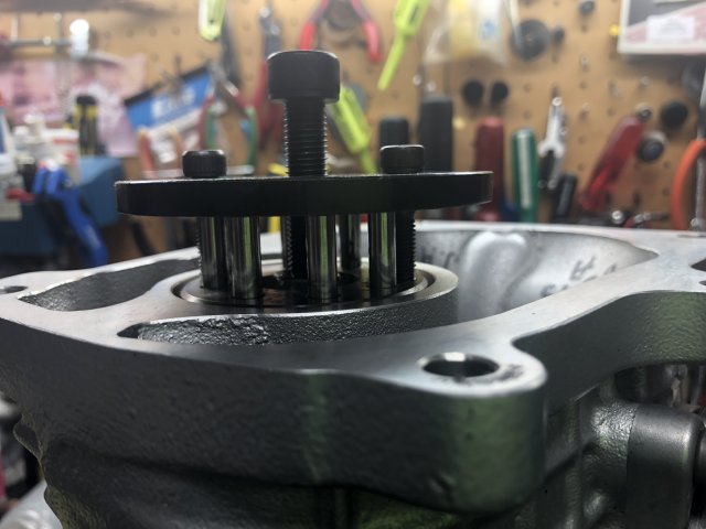

The coupling hub bolt can get inadvertently loosened when removing the drive pulley. By holding the drive pin hub with the Metco tool in loosening the 17mm hex on the pulley the shaft inside the coupling hub can turn inside the hub and the bolt gets loosened and the clamp load lost that’s holding it in place, this happens even easier if a impact is used, it’s one of the reasons why they instruct to not use an impact. To get the hub off takes a special tool, I made a hub puller to pull both coupling hubs off. It’s pretty simple and works great. Once off then you can press the shaft out of the bearings towards the snout front. Then one has to dremel the bearing retention peened over tabs off and press the bearing out, from memory I believe it’s a 6203 there and pulley side a 6204 bearing. You can buy a knew shaft, JB and Jokers sells them. JB may even have the hub in stock as well. D6564385-4EEA-4DFD-8A4E-B42075CE1E73.jpeg CA437EBF-02FB-4986-96DF-108001003822.jpeg 17320AB2-B230-43DA-B239-BFA02AB977F2.jpeg
