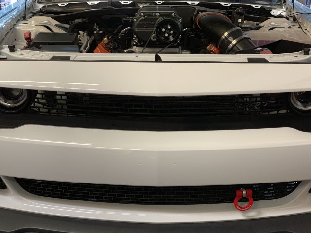

I’ve said this before.... so I’ll say it again. If you run your car at the track..... you could break something. If you do and you are stopped on the track.... you will be pushed or pulled off. With these cars not having a tow attachment point..... expect it to be damaged. They are not going to send out a crew of guys with soft cotton gloves on to push you the length of the track. If you race..... get one if these. 9AD0095D-60FF-48AF-BDCC-F4F709F38CC5.jpeg

I’ve said this before.... so I’ll say it again. If you run your car at the track..... you could break something. If you do and you are stopped on the track.... you will be pushed or pulled off. With these cars not having a tow attachment point..... expect it to be damaged. They are not going to send out a crew of guys with soft cotton gloves on to push you the length of the track. If you race..... get one if these. View attachment 3185
Good advice right there.

Get a tow hook for the front and back. Never know how you'll end up.

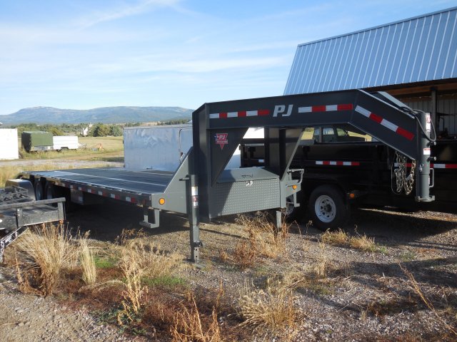

Off subject, but hey, we're talking trailers here.
I'm awfully tempted to buy a new 30-foot gooseneck, this time with a hydraulic dove tail.
Wish I'd got it the first time, since the rest of the trailer would be identical, with disc brakes, air suspension, etc.
So, would anyone here be interested in a 25+5 (5-foot dovetail) that's been used three times, one being taking it home from the dealer? DSCN2795[1].JPG
