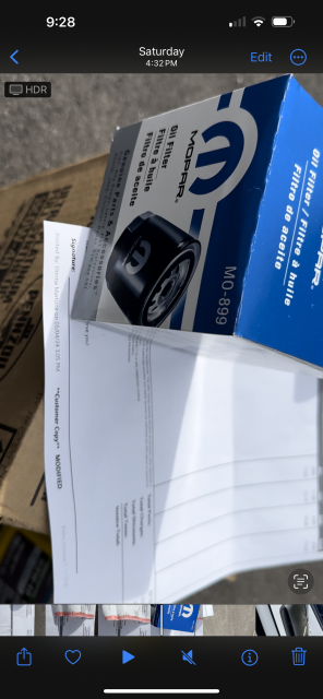

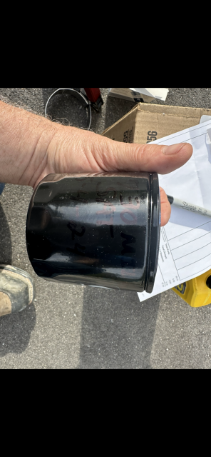

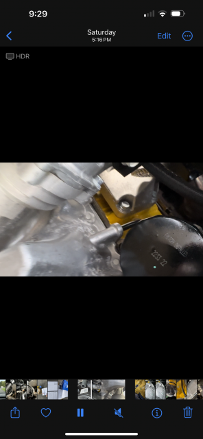

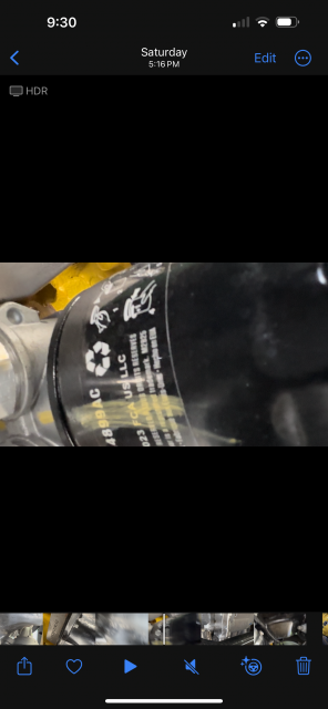

Speedy I changed my oil Saturday @ 730 miles collected the oil measured and poured back into containers, yes mine was 8 quarts and dip stick from factory suggested 8 quarts by the level above markings on stick. I picked up oil and filter at Dodge dealer parts, specifically asked how many quarts does dodge call out and was told 7. After oil change I cut the filter open with large pipe cutter and shears leaving no metal to fall into filter, inspected with no visible nasties. Sent out oil sample to black stone yesterday & will post up when results come back. Also agree no hard hits unless it’s E85 in tank that I am now running. What pressure are you running on the MT’s in the back.
Are the 170s shipping with the MO-899 filter? Just wondering.

Also yes @jroyk M0-899 Filter from factory.
Exact same filter you buy over Ma Mopar’s parts counter, all but for the “Factory Installed” printed on bottom of filter. And the other pressing question answer is yes I drained oil cooler too.
