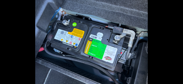

About to change the battery, been over 5 years now and these colder mornings have me not wanting to chance it much longer. Took a look under the trunk cover, looks like 2 10mm bolts on the terminals, only thing is the battery appears to be attached to the car on the side, to the passenger side of the car? Didn't look immediately obvious to this non-mechanic how to free it, so I ask if any of you have encountered this and in there an easy way to pluck it out? Thanks!

That’s probably just the hold down clamp, loosen that and it’ll come up

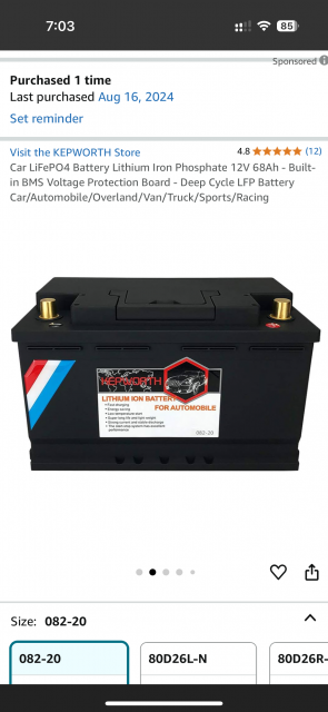

Which one? What'd you replace it with?
7,341
46,797
I got this one. We had a thread on it a while back.

Same one Kepworth, went back to agm. I'm not sure the high cranking amps are good for the starter, like I said I had to replace mine. But then again mines a 2015 with 54k miles so who knows?

Well in a not-shocking manner my battery died today after I got home from work. Fortunately my neighbor was home to jump me and I drove straight to Costco and had to buy an Interstate AGM battery for $180. Had to pull and install on site. Bottom bracket revealed itself once I pulled everything out of the trunk to swap. Unfortunately the vent tube is a different size and does not go into the feeder hole in the battery. Think it is ok to wait to Sunday afternoon to future that out? I am a wrestling coach and we are wrestling today and tomorrow…and Sunday morning lol. I will be driving the car.

Yeah, just a vent for the gases. It should be hooked up but shouldn't matter much for a few days unless your alternator is over charging the battery.
