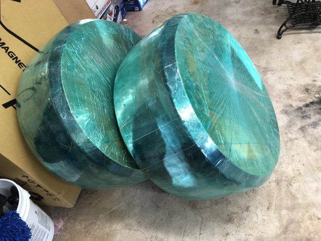

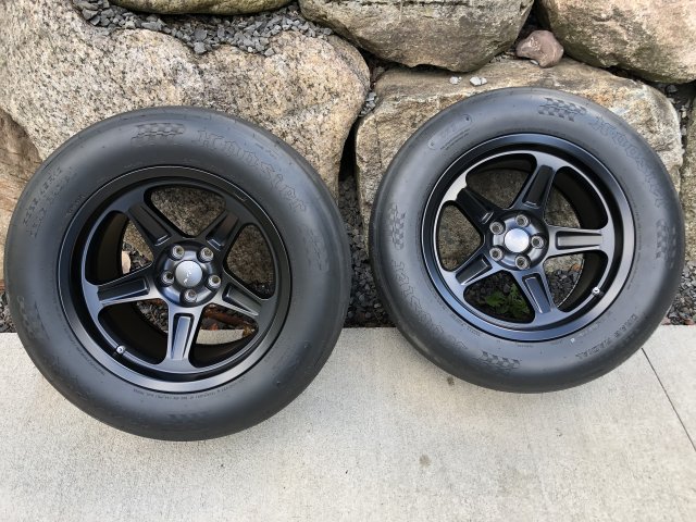

Those wheels and tires should be coming soon… BB7CDCF2-8089-48DB-939D-7A0386977353.jpeg BB7CDCF2-8089-48DB-939D-7A0386977353.jpeg 433A469A-9E19-4FAB-86FD-49309D110A85.jpeg

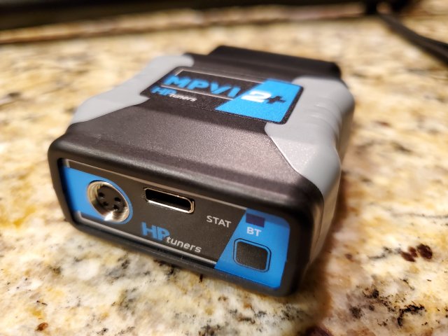

Got the latest and greatest HP Tuners MVPI2+ set up today. Anyone use HP Tuners in here? Would be curious to see what channel configs everyone likes. I got the standalone datalogging set up this afternoon and tested it. It works! All you have to do is plug the device into your OBD port and hit the button to start/stop recording. Alternatively, you can set up custom triggers to start recording based on acceleration, g-forces, etc. No cables or laptop needed in the car! This works out great because my local track just started enforcing that laptops must be bolted down in the car now--not in the floor, not in the seat with seatbelt, etc. I'll be glad to leave the laptop at home.
Also, i'm curious to see the differences in the Demon stock tune (808 HP) versus the Super Stock. I have both files but haven't done a comparison yet... more on that later. 20210919_195435[550].jpg

I assume you did not have to unlock the ECU to just log with the new MPVI2+?
I guess I need to read up about the new version on their web page.

Correct. Datalogging can be done with just the purchase of the software/interface from HP Tuners. No credits or licensing required (no unlocking PCM).

Are you able to log knock retard and Injector duty cycle with that device and no laptop? Did you install the security gateway bypass cable [the hp tuners version installs behind the radio].

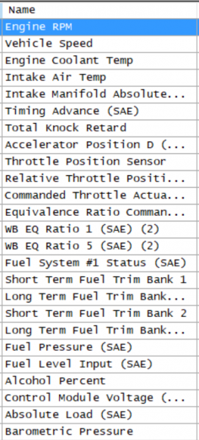

I am just datalogging for now, which so far is working fine without the bypass cable. I haven't changed any of the PIDS yet, but the default one has knock retard. I'm sure IDC can be added as well, but I'll figure that out shortly since I want to set up a custom set of parameters to log.
Here are the defaults that were already set up (except for ambient air temp which is at the bottom): Screenshot 2021-09-20 222956.png

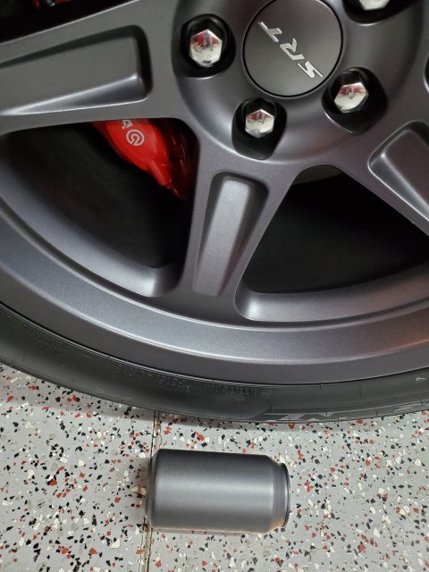

So while I'm waiting on my backordered Weld 17x10 rears, I found a set of Demon wheels from a forum member. Was trying to figure out how to get the Demon wheels powdercoated to match my Super Stock wheels (granite gray) but think I may have found a "quick fix" to go racing and have a close match. I remembered I had some anthracite gray plastidip on the shelf from years ago so I went to check. Found a test subject (aluminum can) and these are the results. It is so close that I don't think anyone would even notice! I will give that a try and if I don't like it, I can peel it off. 20210922_190652[560].jpg

I'd call that a match.
Run with it.

Nice match on the Plastidip!

Just because the PID appears, does not mean it will populate with data from the car. I was unable to log those channels on a locked pcm with my mpv1

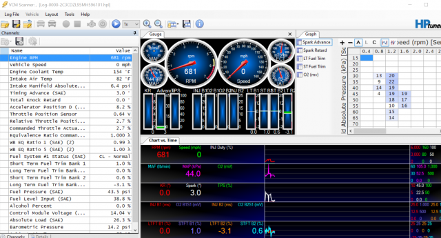

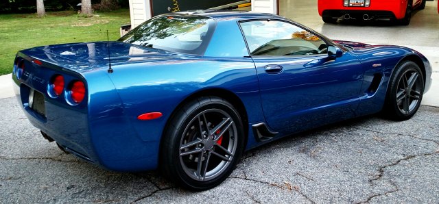

Here's a picture of what I last used the anthracite gray plastidip on... These wheels on my 2003 Z06 were "hyper silver" which appeared to look like polished aluminum and I didn't like it. So I put the anthracite gray plastidip on them and this is how it turned out: IMG_20150831_222828.jpg

based on your screen shot, you do not appear to be logging IDC or TPS...as there would be a numeric value there if you were...
You originally asked about knock retard and IDC, and I said knock retard is logging fine (as you can see). I haven't had time to figure out injector duty cycle yet, but I understand it can be done as a math calculation using injector pulse width since there is no actual PID for IDC. My main concern is datalogging since I'm not tuning this car anytime soon, and so far it looks like it's going to work great.
