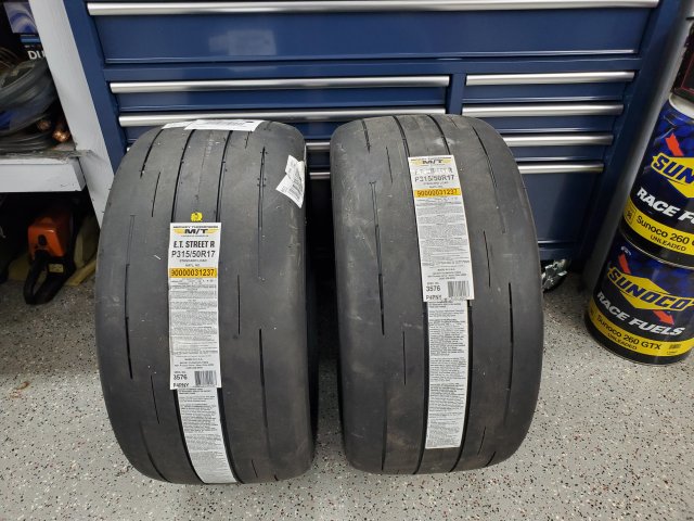

Trying to get a little fancier with my video editing... Not my best ET's by a long shot (horrible 60'), but this was a new best MPH for me. Should go up a bit more once I get back down into the 1.3x 60's. Got a set of 315/50/17 ET Street R's coming Friday (sent the 315/55/17s back since I wasn't sure if they would have clearance issues).

Let's see if these will do the trick in my quest for 6.teens! 20230407_145702.jpg

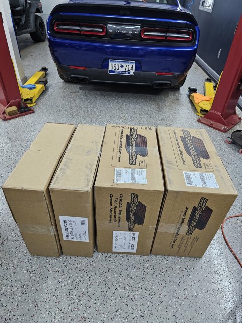

Some goodies arrived today... 20230512_130555.jpg 20230512_131616.jpg 20230512_131007.jpg 20230512_131401~2.jpg

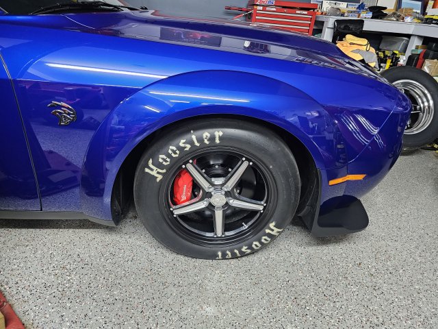

Car is dirty from the last track outing, but here is a look at the Billet Speciatlies street Lites mounted. 20230517_163141~2.jpg

Those look really good. I'm glad to see them on the car. I think I'll get a pair of the fronts to use with my 15" rears. They will look a lot better than the Win Lites when paired w the Welds.

Thanks! I agree... I will have my front Weld skinnies for sale soon but I'm sure you're looking for the lighter weight of the Billet Specialties wheels just like I am! 👍

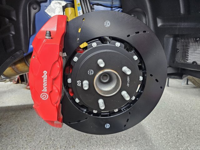

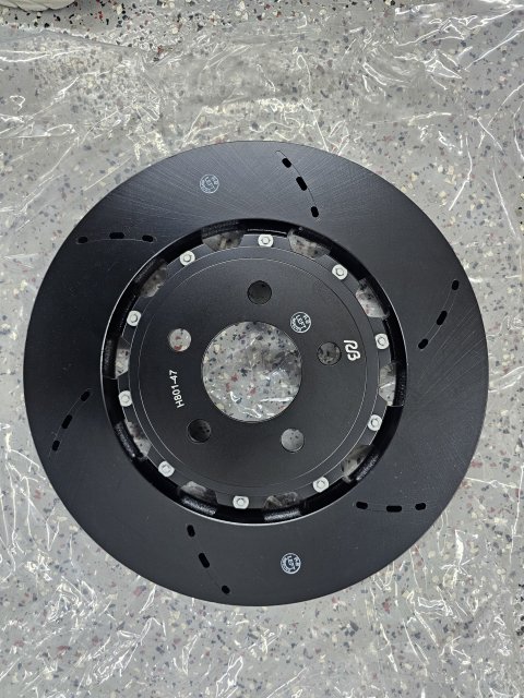

Lost some more weight today. RB Performance Brakes front rotors. Between these rotors and the spacers i was using on the front, i just lost 11 lbs per side! (After losing weight last week with the Billet Specialties wheels). 20230531_131309.jpg 20230531_201403.jpg 20230531_201737.jpg 20230531_210613.jpg

Rotor for rotor, how much lighter are the RB's?
BoostedGTA
BoostedGTA
#8108
189
415
Greenville
SC
2021 Super Stock
Thread Starter #277
8 lbs lighter (27 stock, 19 RB).

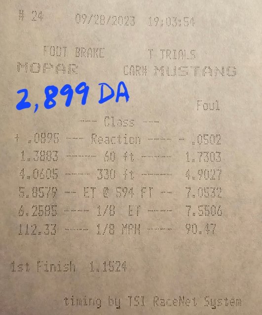

Haven't posted any updates in a while... Our weather in upstate SC is starting to cool off but still haven't had any great DA track days. Nevertheless, I did run a new best last week of 1.38/6.25/112! Gotta love this car, the only mods are E85 tune (with ID1300 injectors) and weight reduction with wheels/tires/front rotors!
