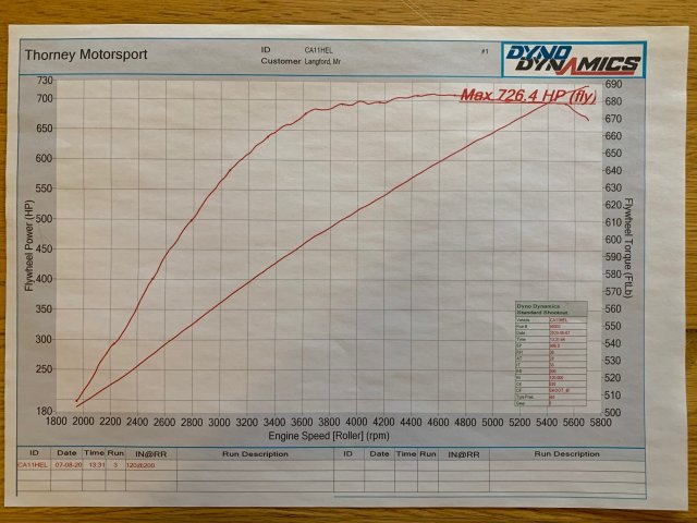

After five years i'm finally getting around to tuning the Hellcat.
Josh at HHP is doing the tune.
I went for a 2.85 litens pulley, Demon injectors and a 180 degree stat. I am only running your equivalent of 93 pump gas, nothing special.
So I thought it was a good idea to get a base dyno run done first prior to the mods so we know where we are prior to the tune.
It was the plus side of 90 degrees today so not the ideal day to dyno the car.
The Diablo Trinity 2 is a ball ache to work with and we ended up with a check engine light this afternoon that has hopefully cleared.
I'll take it for a run tomorrow.
I know dyno runs are subjective but quite pleased with the result.
Two weeks today we will be back to this dyno for a post mod run and we will see what we end up with.
Josh is going to do a remote tune
54,718
183,964
flywheel? Can't say I have see that from a rwhp dyno

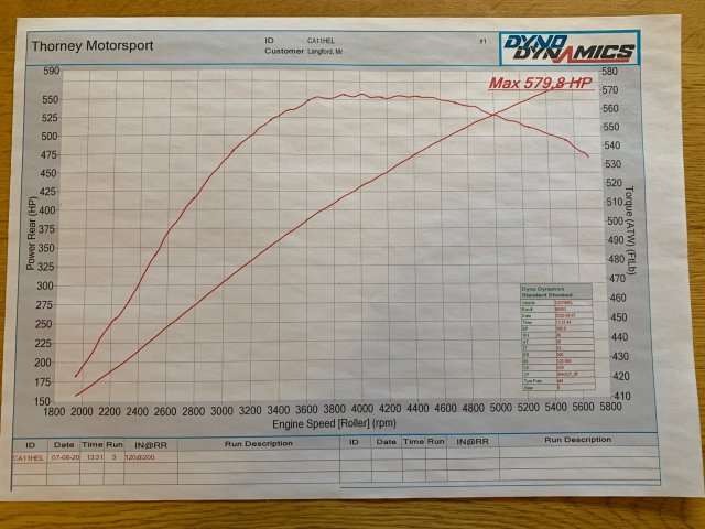

My apologies. Here are the figures at the rear wheels

Is your HC totally stock?
I’ve read other articles that say stock will dyno RWHP around 640-650 HP

Yes totally stock save for the Toyo R888R tyres that got pretty sticky on the rollers

dyno's are different and are only a tool. Nice to use to see before and after numbers after making changes. I will be looking forward to the after numbers

My stock dyno run was 640 HP. What was the DA like in that area? How was the humidity? Also what was the cooling like in the shop, hopefully they had a big ole fan blowing at your front.

I have no idea what the da or humidity was. It was a hot day for the UK and most of the UK is not much above sea level. Yes a bloody big fan. They carry out a lot of Mclaren tuning which is why I wanted to use their dyno

Da in Northampton has been about 1400 all week, it’s 1800 today With 67% humidity.Dont know where the rolling road is tho🤓.

That's pretty normal. When I had my '18 it dyno'd about the same in Florida heat.
I was told by AJ Hemituner himself you could see a 50hp difference on a Hellcat from a 40 something degree day to a 90 something degree day, maybe more, when he tuned my Magnuson blown SRT8 a few years ago.

That is why you should always use SAE. Would make no sense to dyno a car in the summer, change a part and do it in the winter. The HP numbers you picked up could all be from the colder weather
