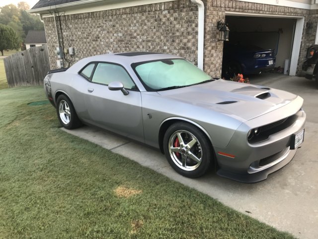

I went thru nitto nto5 rd with the added boost you will definitely need 17 inch racestars and Mickey Thompson street etr 2C1FE172-6E12-4E81-8FB4-1F7CFE27445F.jpeg

Very nice...I will definately be looking into 17s...did you have to change anything for fitment

Very nice...I will definately be looking into 17s...did you have to change anything for fitment?
Just thevrear sway bar links
If you get them also be sure to move your shock wire so they won’t rub
You can get shorter sway bar links from hhp they are easy to install
