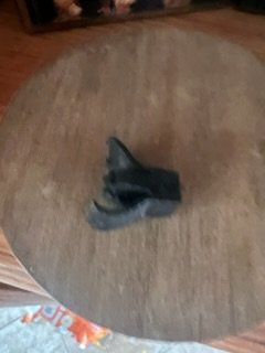

It is on my front fender flare and is broken. I know it is a plastic insert with screw. It is large to fill the hole at the rear of the wheel well in the front. Anyone have any leads?

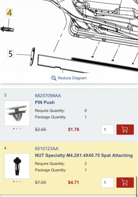

For stuff like that I normally use the parts breakdown views. Just search for a large part like the fender flare, and you will then find this part numbered in the breakdown illustration. From there grab the part number and search for it.

It’s not. But you did help me. :) it is the pin. And that pin I could not find anywhere.

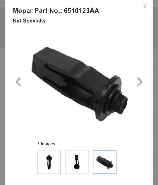

Yes. It is a huge push in pin with a screw with a small hex head. Is there a particular part number for that?

Yeah it becomes important with the flare.
5,663
4,691
I found it - I sec
5,663
4,691
I took my front ones off
5,663
4,691
#4.

Holy moly! You are the man!
