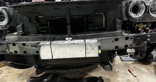

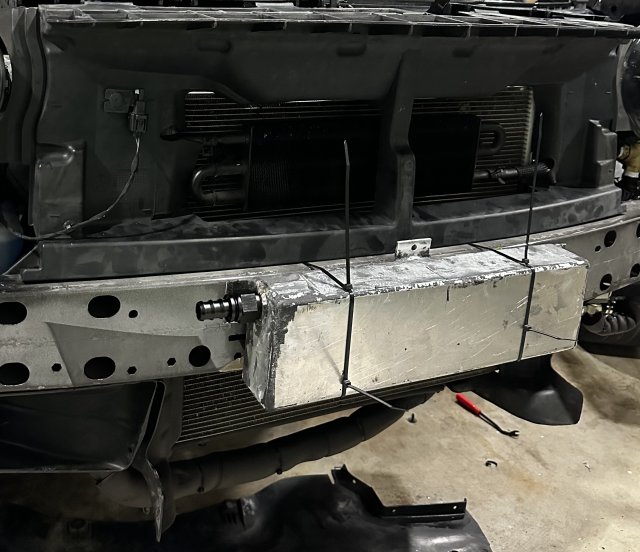

Mocking up a 1.25 gallon custom tank for the chiller. Have a lot of work to do, need to fix several leaks. One of which involves having to cut the aluminum fitting from the brick.
Will be using rivnuts in crash beam to mount tank. New insulation for tank on its way

Mounted with rivnuts, test fit bumper half a dozen times and made adjustments. Now onto redoing the valve and cutting the fitting off the brick

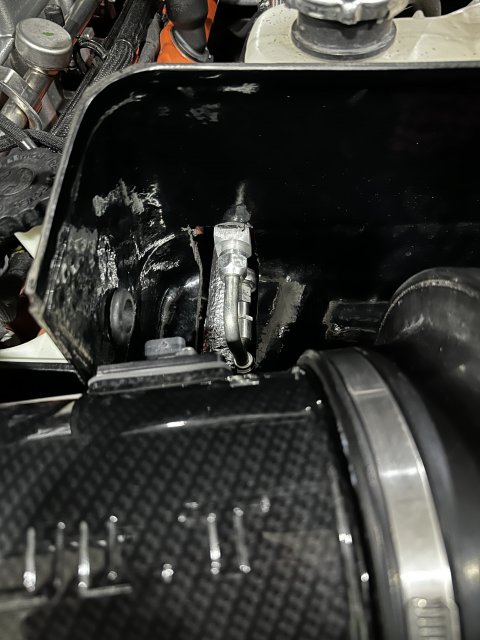

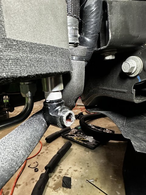

How to remove your old aluminum brick fitting without cracking open the AC line 🪚🫠 dremel with metal cutoff wheel made short work of it

Tank insulated and mounted
5,663
4,692

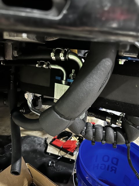

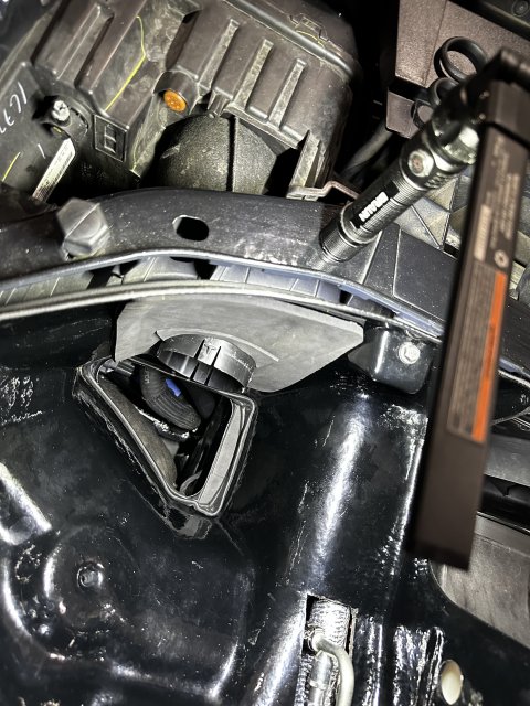

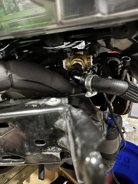

New swivel fitting should work.
5,663
4,692

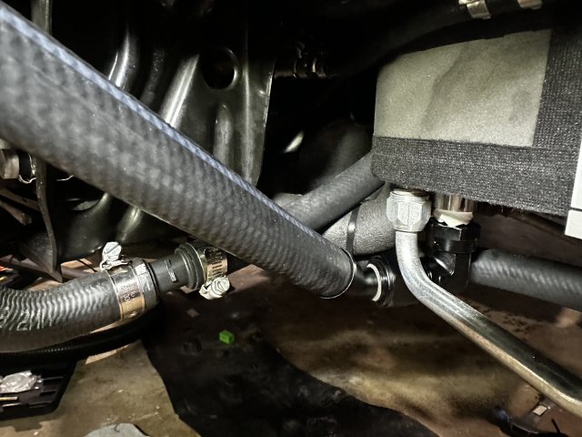

Hoses need to be ran from the top. Plumbing is all good

Tank installed, all back together and zero leaks

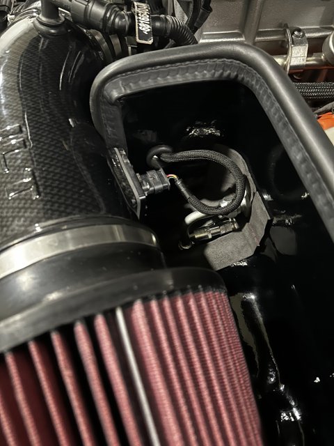

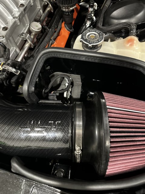

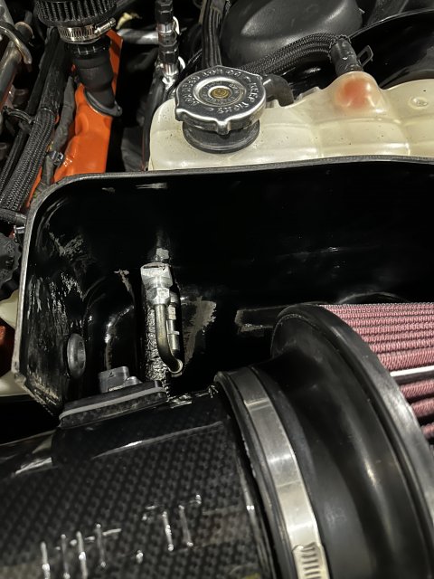

Installed my JLT box, cut a bit to clear chiller lines. Will put some foam tape over it

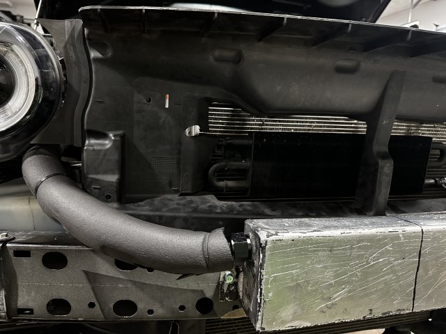

Thread Starter #18

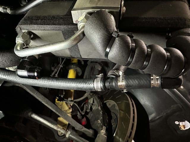

All buttoned up
