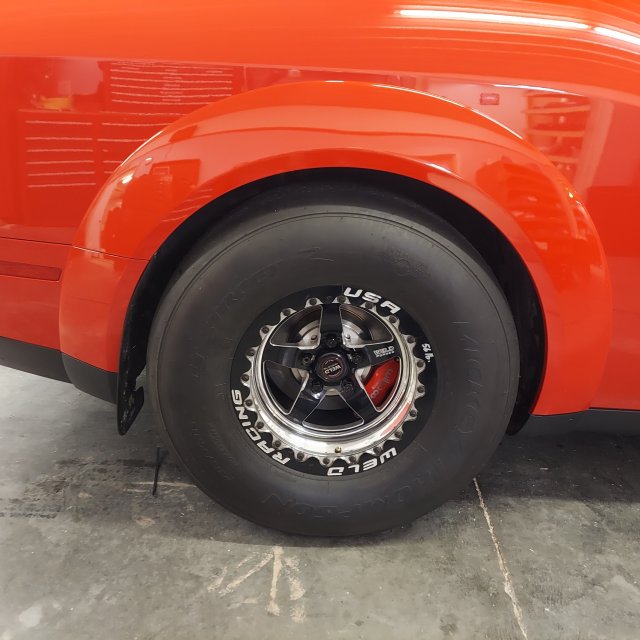

And these 315/60-15's are big. 20230103_170028.jpg

I bet it is a different car with those installed.
56 LBS.?

I don't know exactly what to expect from these tires Mike. I plan to run the car some this upcoming season and our local tracks aren't exactly known for being particularly sticky so this seems the way to go. On a killer track I'd say a good 17" might be quicker - solely from the weigh savings.
The 56lbs is the weight of that wheel/tire. For comparison my 17" Billet Specialties w the 28" Hoosier weighs 42 lbs.

Them’s some big ass tires ! Sure fill that wheel well nice.

They are big! They're pretty much all that'll go under the car.

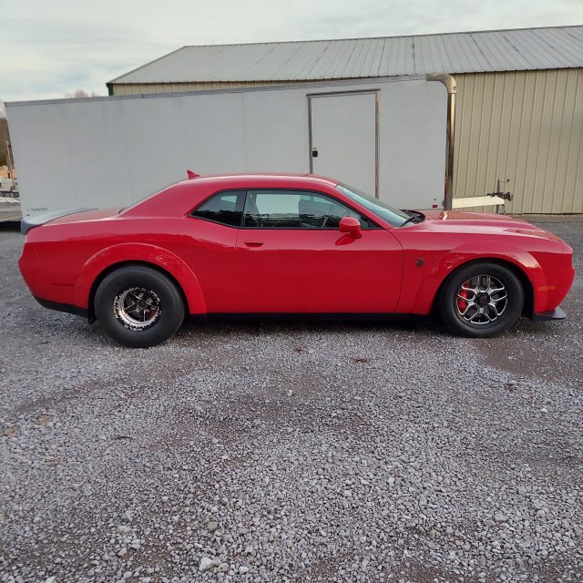

Injector swap went smoother than expected. E85 tune is uploaded. Car is ready to do some road time and some pulls so Jon can get things dialed in. Hopefully that'll go smoothly and my to-do list will be complete.. for now. :p
