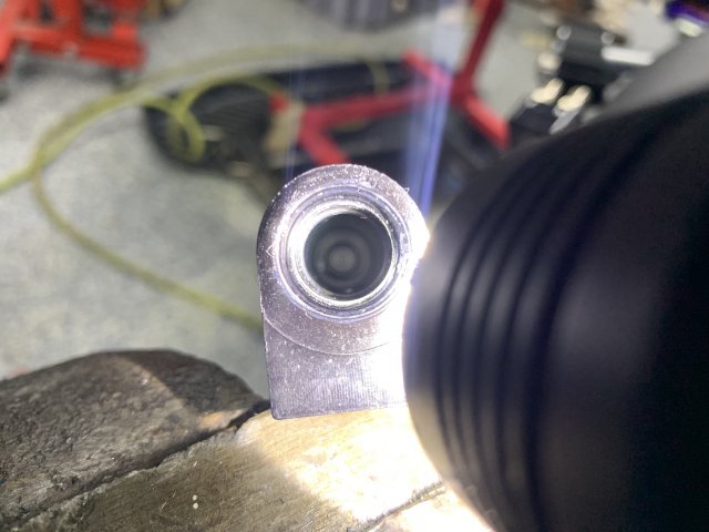

The stock fuel rail is a whooping .650” ID, the Fore Rail is 1/2”, around .500”. So there’s no reason stock rails can’t keep up once the restrictions are removed. I’m going to mod these in the next few days, but unfortunately this upcoming snow storm is really going to put a dent in getting out to test them under extended WOT top of 4th gear 1/4 run in same conditions as previous runs.
Here’s looking down the barrel of a Fore Rail, stock rail ID calculated from OD minus .050” wall thickness of tube used to make them.

Already had a plan for this. I Drilled one out today, I pressurized the rail with clean and dry compressed so all the chips flew out as they where generated. I drilled them out about .015” at a time, I still need to debur the holes in the injector bungs which I have a plan on how to debur both sides of the holes already as well but I’m elated how they came out. The inlet feed looks the part now for a 1/2” line!!
Primary inlet went from a .277” restriction at the inlet of the rail to a whopping .413”!! the feed port out of that rail that feeds the drivers side rail went from .213” to .302”!!. I drilled the injector bungs out from .113” to .204”, I stopped when I started getting close to the spot welds that hold them to the rail but they are brazed in place as well and no compromise in strength what so ever. The hole is now almost twice the diameter at .204” and will be plenty as it now almost matches what the feed port to the entire drivers side rail was originally!! I wish they were both done today as I would have gone out tonight and tested them before the snow storm starts tomorrow of which now projections are 18-24” in my area, yuk yuk yuk yuk YUK!!!!
Tomorrow drill and debur, and blow out from a bunch of different ways, fluid flush into a fine screen so I can see how if even one chip was left in the tubes them get them in the car and waiting for this crap to melt for testing.
