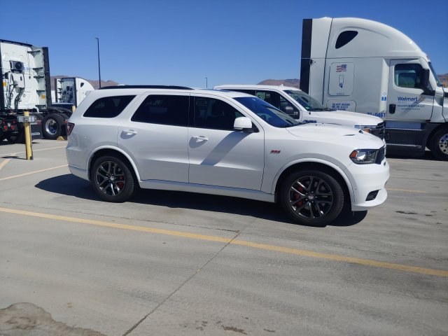

Gratuitous DSRT pic...😂 Also had a warehouse guy say "nice truck". That still cracks me up. Truck. 20200927_131539.jpg
5,555
10,664
I've heard people refer to S-10s as "trucks", and even Trackhawks.
Must be something in the water.
