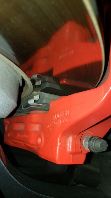

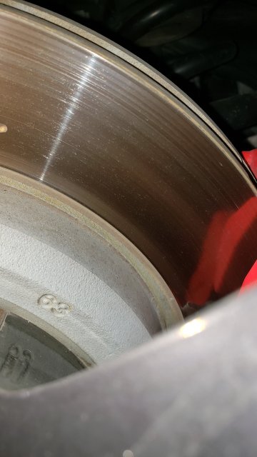

Dealer said my rears are at 3mm and they'd probably have to resurface my rotors too. I said "at less than 12K miles?" and he said he's seen some that needed them at 8K. WOW. Honestly, I don't run my TH hard since it's my DD plus the ongoing pandemic it's really been sitting for the last 9 months. Anyone else with a similar experience?

Pictures of your rotors would help.

Seriously, pictures.

14,769
45,391
Note the wear strip on the pad, this is at ~15K miles.
