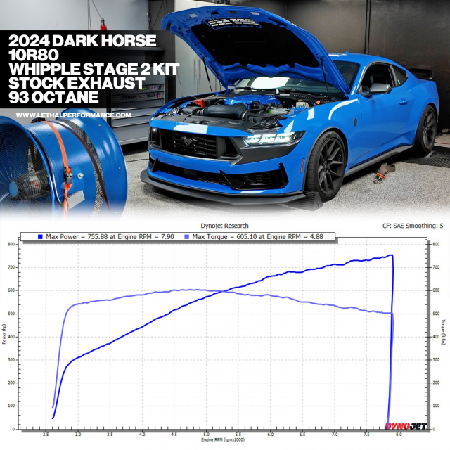

Supposedly 50 state legal when released. Pretty crazy. Gonna hurt some feelings, you think it's got a catback and goodbye!

A riff on the Roush stage 2 kits with a Whipple instead of a TVS SC.

only problem, will be getting that 10r80 to hold up

My understanding is they don’t hold up
Car was built with 500hp in mind.
Making 800whp is going to stress components.
Several Mustangs and ZL1s have been in the 9s with this 10 speed trans. And like the ZF in the Hellcats, they can be built to handle more power.

I see a lot of these 10 speeds come in with the sleeve issue in the CDF DRUM mostly happening around 70 k

I agree needs a few upgrades but plenty have actually lived at that power level. My 6r80 holds a shit ton of power but its got all the billet internals from Brett Lasala.

The weak point has always been the OPG's.
Those 5.0's and 10R's will handle the power otherwise without major issue as long as the tune isn't done by a potato.
