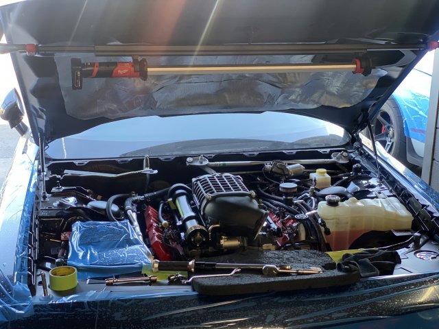

Making some progress this week. Maggie is back on the car. 52510FC1-59E6-41F4-AD6D-797F266D62C2.jpeg
Today or Monday will be the engine flush and fresh oil change.

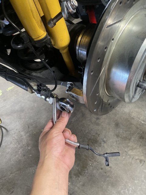

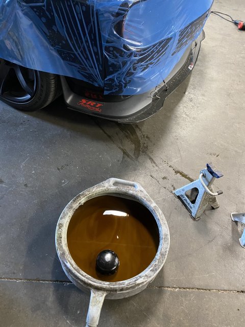

7E6531BC-9D53-4F00-AE79-A34A88F69CC0.jpeg 76C40CCB-2B3E-42F0-9F3C-182C4CE2FDCF.jpeg Shop did 2 oil changes to flush out coolant.
Also finishing up the 15 inch Carlyle conversion.
Need to find some new nuts and bolts for the rear lower control arm. Bolt is to close to the wheel.
Getting closer and closer! Just some small inconveniences but all is going good.

View attachment 43924 View attachment 43925 Shop did 2 oil changes to flush out coolant.

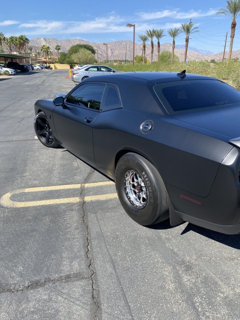

85E83130-366C-49BB-A993-8D70E96253F6.jpeg FC84CD99-8350-4750-BCD4-C631ACAE980D.jpeg 29057E81-41AE-4170-9781-EC15AF806A4C.jpeg
Finally have some time to update this thread.
Car is done and running good for now.
HP Tuner is in and Diablo is gone.
Tuned by Z Tunes and car is Primetime now.
Found a new shop closer to where I live that finished up the car.

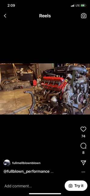

Car is just sitting in the garage for now. Soon as I get the heads off to Full Blown Performance and it’s gonna be Primetime.
