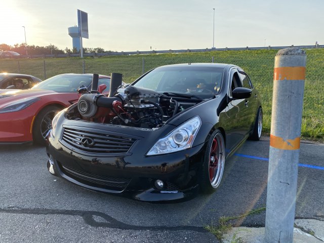

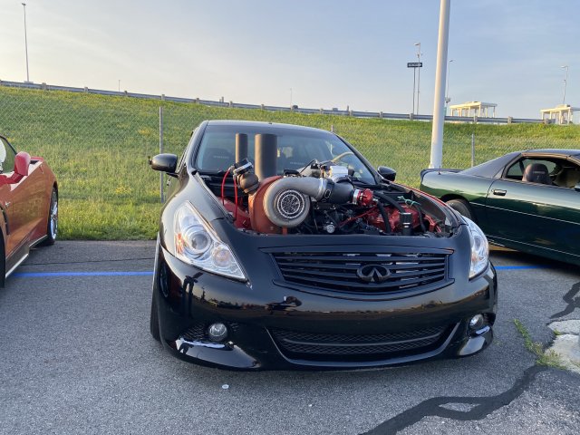

I think he overbuilt the car.
Is there such a thing? Over built ? LOL

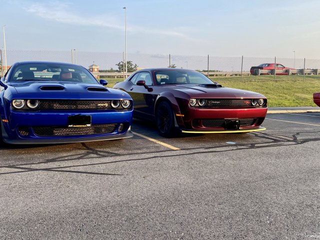

Just look at this conservative build. I think it’s too stealth, and certainly could use some more boost. Seriously this guy wants to grenade that thing. Hope his wastewater is set to open before he hits the build point of power plant. I saw it at Gillette stadium the other night. 1,200 cars. The show is every other Thursday, usually something there for everyone. Always see something new and cool, be it resto mod, rat rod, Bike, military, brass era, 50s 60s70s and yes our modern boosted Cats.
My car is the conservative stock boost Indigo RE. WB.
