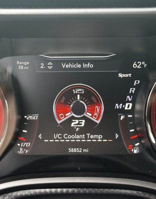

Temps that low always worried me. Iron vs aluminum heat expansion rates and what not.

This is the problem people worry to much. Jon can have my back on this one. I ALWAYS say just send it with my stuff. I have never said nope not doing that.

That was just showing how good it chilled is all while driving around the other day

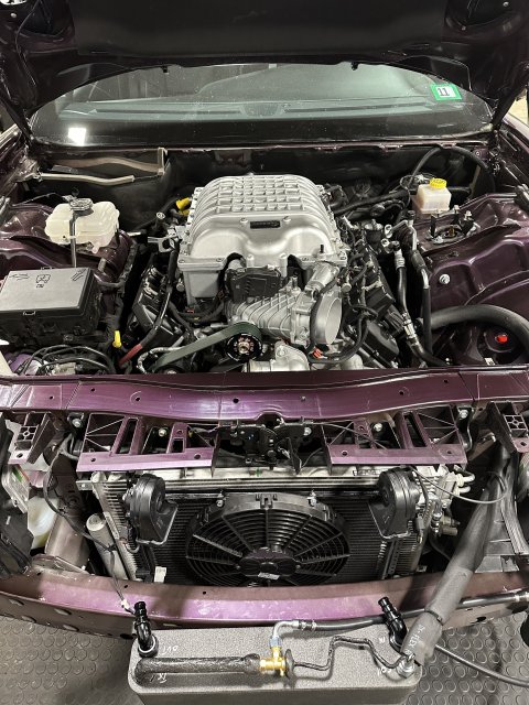

Finally got the hater maker special stuffed into the engine bay. We’re close, folks. Thanks to anyone who has stuck around. This has been a serious test of my mental health. :ROFLMAO:

You drop the subframe to do it?
Not sure. This is being done by a shop about 45 minutes away from me. I know the transmission came out, if that makes any difference.

Transmission now in. Shop is/has been short handed so they're trying to chip away at this as much as they can. Fabricating the water tank for the FI Interchiller system today and will then get that installed. I imagine after that it's probably just some exhaust work and we're done. Hoped to pick up this week but feel like that may be a long shot.
