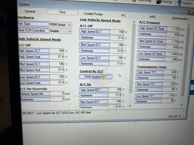

So just a thought here. Your car was retuned is it possible the tables were set to Celsius and they put Fahrenheit numbers in?

Thanks. Go to system, fans and look for?

Just looked. Farenheight
4,263
10,596
Ok and the numbers make sense right? Because I could write a tune in C and then you could open it and it would convert to F

Pwm linear is on. Fan fcm disabled.

I will try taking a picture.

160’degree thermostat. Pwm desired ext set to 163

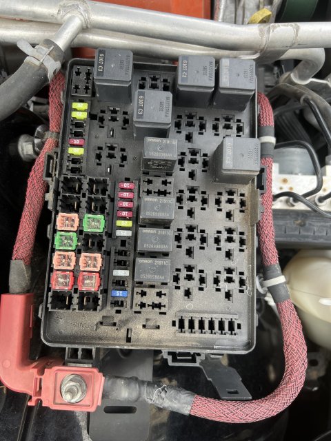

Am I missing any fuses or relays?
AlleyCat
AlleyCat
#1332
812
736
82
Oro Valley
16 HC Challenger
Thread Starter #20
They look all there compared to pictures on the net. The 50 amp ones look like toast.
