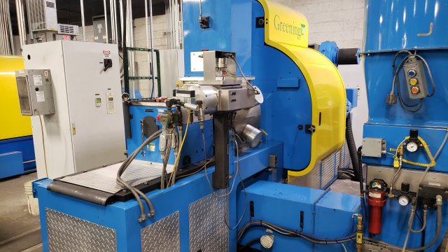

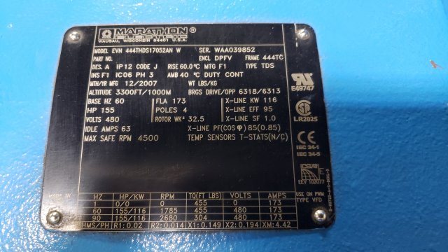

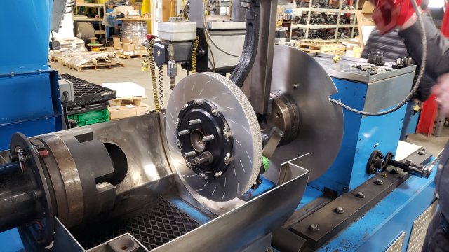

Dyno test on your car? Do you mean your rotors on a car on a dyno spinning?
Dedicated, specialized brake dyno. You should see the electrical motors that drive these things, and the power they take to drive them. Gigantic (tunable) flywheels to simulate the mass of the car.
Disc flatness tester
