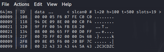

that's why I created this thread, to help get information out. Today I'm learning how to sniff the traffic the controller is throwing around:
The 2C3CDZC is the beginning of the vin, and the id of the controller throwining it around is 0x3e0, a few milliseconds later it will broadcast the rest of the vin. Right now I'm going to be setting up some brute forcing to see how you can get data with Caring Caribou (can utility). I'd like to see how to receive a PCM read and ultimately a write. I don't think any of these utilities exist right now on linux.

Small update, have been working on figuring out how to speak the correct language on the canbus, been doing a lot of research and found that the system uses ISO-TP. This means that if I send data to one arbitration ID (unique id) it will appear on another. This means I have to setup a sender and a listener. There are some good open source tools to do so namely isotpsend, isotpsniffer and isotprecv. All of them have quirks and nuances but make gathering intelligence easy. On top of the ISO-TP layers sits Unifited Diagnostic Services (UDS). UDS is to guarantee that any mechanic in the world can diagnose a car without paying stupid money to a higher conglomerate for proprietary data. These services are pretty well defined here: https://en.wikipedia.org/wiki/OBD-II_PIDs, andything above 0x10 is propriety but I have also enumerated those.
So when doing some enumeration I used the tools like follows (have to put it in a monofont):
to enumerate: echo "01 00" | isotpsend -p00 -s 7df -d 7e8 slcan0
response: slcan0 7E8 [8] [SF] ln: 6 data: 41 00 BF FE A8 93 30 - 'A.....0' - [???] Unknown
The bytes returned are hex encoded so that 1 means supported, 0 means not supported
1 0 1 1 1 1 1 1 1 1 1 1 1 1 1 0 1 0 1 0 1 0 0 0 1 0 0 1 0 0 1 1
Y N Y Y Y Y Y Y Y Y Y Y Y Y Y N Y N Y N Y N N N Y N N Y N N Y Y
1 2 3 4 5 6 7 8 9 A B C D E F 10 11 12 13 14 15 16 17 18 19 1a 1b 1c 1d 1e 1f 20
So of note you can request 01 20, 01 40, 01 60, 01 80, 01 A0 to find all the pids supported
all the way through 00 - C4, I would rather do this programatically.
