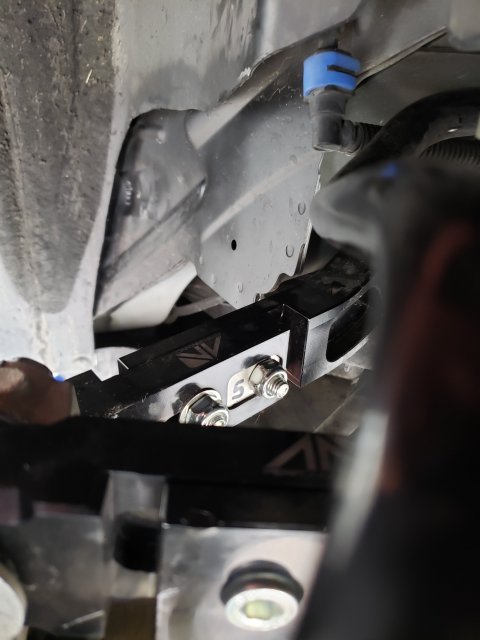

Put the 6 tabs in the passenger side. The long arms would not come apart when they were new. I had to use a rubber mallet to knock them apart. Well they were not budging with all the bolts loosened. I disconnected the outside bolt and was able to tap it apart again. So what I thought would be quick job turned into an hour. I get to do it again when my 5 and 7 tabs come in

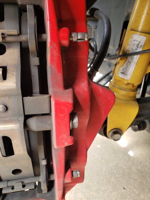

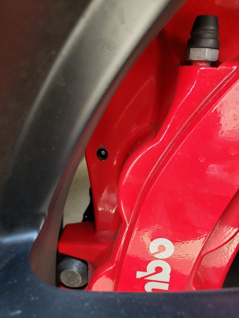

So an interesting find yesterday. I was changing out the wheels and decided to wipe down the calipers. I noticed the pins that hold the pads in were coming out. You can see them from the front the pin should come through but I guess I didn't notice. I have no idea how long this has been this way. Both fronts. The rears were fine. Pics are the back of the driver side and the front of the passenger side

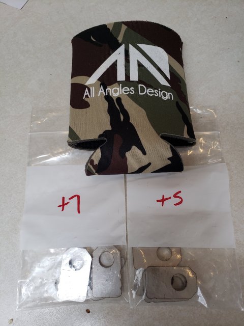

Tabs are here. Talked to Parker Wednesday night and they were sent out Thursday. They sell them in set of 8 because the front arms take 4 each. If you need 2 sizes like I did he said to order 1 and put a note in there you need another and you can get 4 of each
View attachment 73296 View attachment 73297
That's weird that the pins popped out, you change the pads b4 ? maybe they didn't get seated good or they need a little Anti seize to move with caliper / rotor movement when braking.
They were changed out 2 years ago. I will keep an eye on them

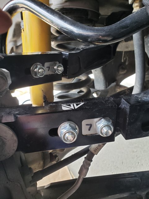

Changed the tabs out today. Went faster being I knew what to do from Thursday. I ran into the guy I work with at the shop were I had the alignment done. He said he is off next week so the week after I will have it checked

AAD sells them all. -9 to +9. Never would use +2 and below. I think with them giving you +2 +4 +6 you may be able to hit what you need. Of coarse I needed +5 and +7
Based on what the arms come with and what other have used, if you buy +5 and +7 I think you will have a good chance of having the tabs you will need since you will have +4 to+7
