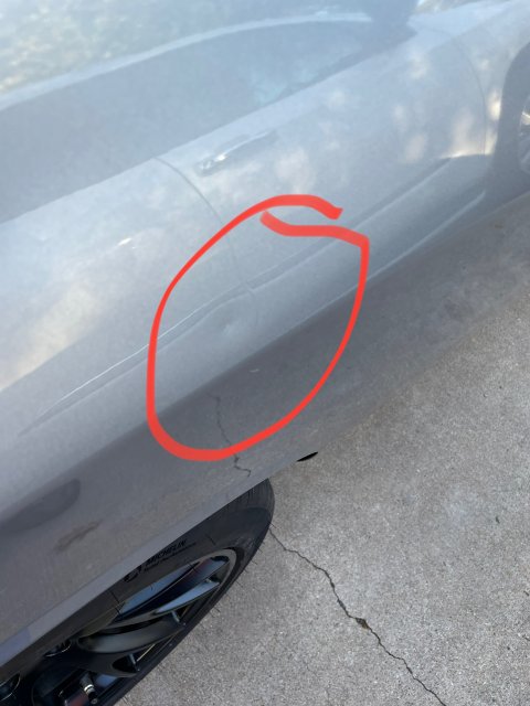

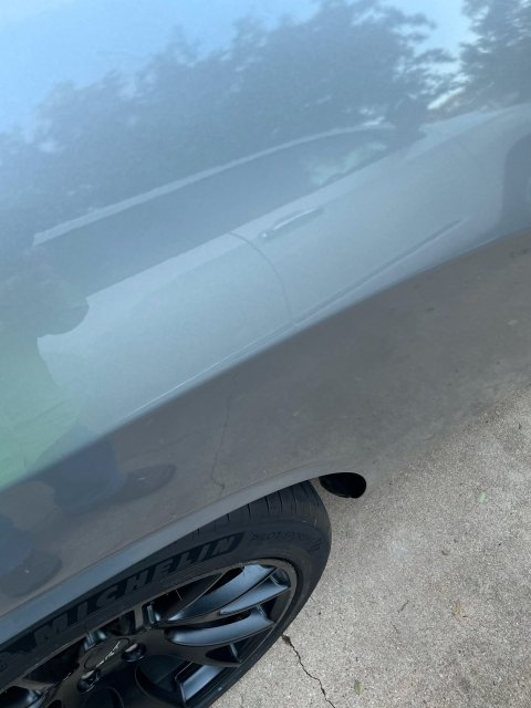

I put this door ding in my 2016 Hellcat myself so I cant blame anyone else. Decided to see if I could make it better, and while I can still find the spot and there is a tiny dimple, I don't feel like i need to throw up every time I walk past. Here's a before and after photo. I bought the paint less dent repair kit off of Amazon

Nice!! I may have to try one of these in my wife’s car as it’s a f n mess from inconsiderate A holes.

Great job! Appears gone

Good job, do you have some tips or details how you did it ?
Watched a Youtube video, only thing I can add is don't try to put too much pressure on it. The glue popped loose twice, and I had to remove the glue and reattach, but each time it pulled it out a little more. All and all I'm pleased for $49 investment.

Looks good! Impressive for a $49 kit.

Not bad...but its still gotta bug the hell outta you...

Nice job, much better than before.
