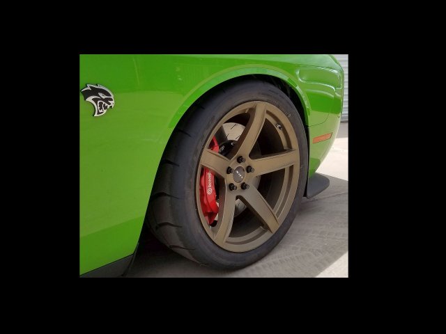

I went with the HR-5 wheels, in Bronze. 5 spoke replica, but 11.0" wide in rear with the Nitto NT-05 315/35X20.
In front, stayed with a 9.5" wide, but upgraded to a Nitto NT-01 285/35X20. Car is lowered an inch+ or so (KW adjustable springs) and never rubbed anywhere.
rear showing no tire outside of wheelwell.
