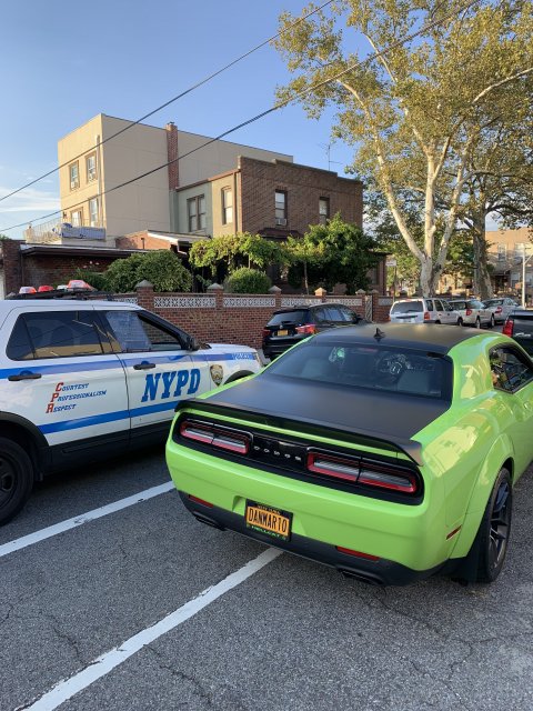

Can anybody suggest a good one to clean the black satin inserts on my red eye. It is paint from the factory, not a wrap. I’m using a spray from Chemical Guys but it leaves terrible streaks and unevenness.

I have it, and have experienced the same thing.
What I have learned is to let the car sit overnight, inside, such that the car is as cool as possible, even cold perhaps.
Then apply to microfiber towel, a bit more than seems right, and then quickly from front to rear, overlapping, while still inside, OUT of the sunlight.
The results are dramatically different than applying to even a slightly warm hood, even if not in sunlight.
When I did it this way, I was very happy with the results.

Gotcha. I’ve made the warm hood and the sunlight mistake. I’ll try it out in my garage.

Are you using Chemical Guys Meticulous Matte Detailer & Spray Sealant?

Yea, that’s the one.

Assuming all is basicly clean, maybe a little dust, etc...I use Dr. Beasleys Matte waterless wash, then immediately follow with Dr Beasley's matte final finish. Looks terrific! They have a combo that starts with matte cleanser, then matte paint coating. Then day to day is waterless wash if needed, finishing with the matte final finish. Btw, I do this with factory painted hood and spoiler, as well as matte wrapped roof and trunk. All smooth and good, very happy with results.

I am going to go with what Bull is saying as that is the same stuff I use for my CF stripes and it works great.
