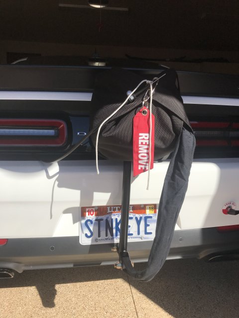

Carlin Fabrication in Calimesa Calif. They are making production mounts now for the Challenger and Charger. The mount is removable once the initial attachment to the frame is done. 2366A121-79DC-4454-A450-718FA96E72F5.jpeg

Carlin Fabrication in Calimesa Calif. They are making production mounts now for the Challenger and Charger. The mount is removable once the initial attachment to the frame is done. View attachment 86391
Perfect I’ll reach out to them Monday. Thank you.

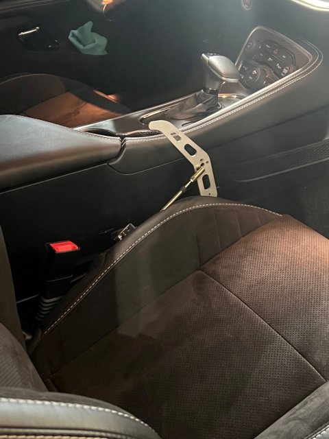

That is for a single Pro Stock size chute. Stroud is the most popular and generally what Carlin installs. You don’t need 2 chutes until you go over 200 mph. The single chute is required at 150 mph. EC8F8685-F229-4594-ADAF-7F36F668F7E3.jpeg

That is for a single Pro Stock size chute. Stroud is the most popular and generally what Carlin installs. You don’t need 2 chutes until you go over 200 mph. The single chute is required at 150 mph. View attachment 86826

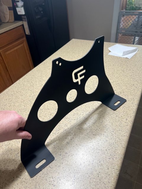

Chute and engine diaper for now. I love my car too much to put a cage in it. I personally think that's going to be my deciding factor on how far to take the car. The more thought I put into it the more I'm just going to stay around the high 8's for a while. I think my idea at the moment is to build a stock displacement bottom end with billet rods and diamond coated pistons a set of good ported heads and a custom spec cam. Make it capable of mid 8's on boost. While still being a reliable street toy.

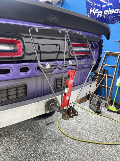

9B4291D7-37B9-41E4-B51C-F4501C7C73F4.jpeg 9B4291D7-37B9-41E4-B51C-F4501C7C73F4.jpeg Im making a duel chute for mine now. Had a single one sending mount to David S and selling the chute.
